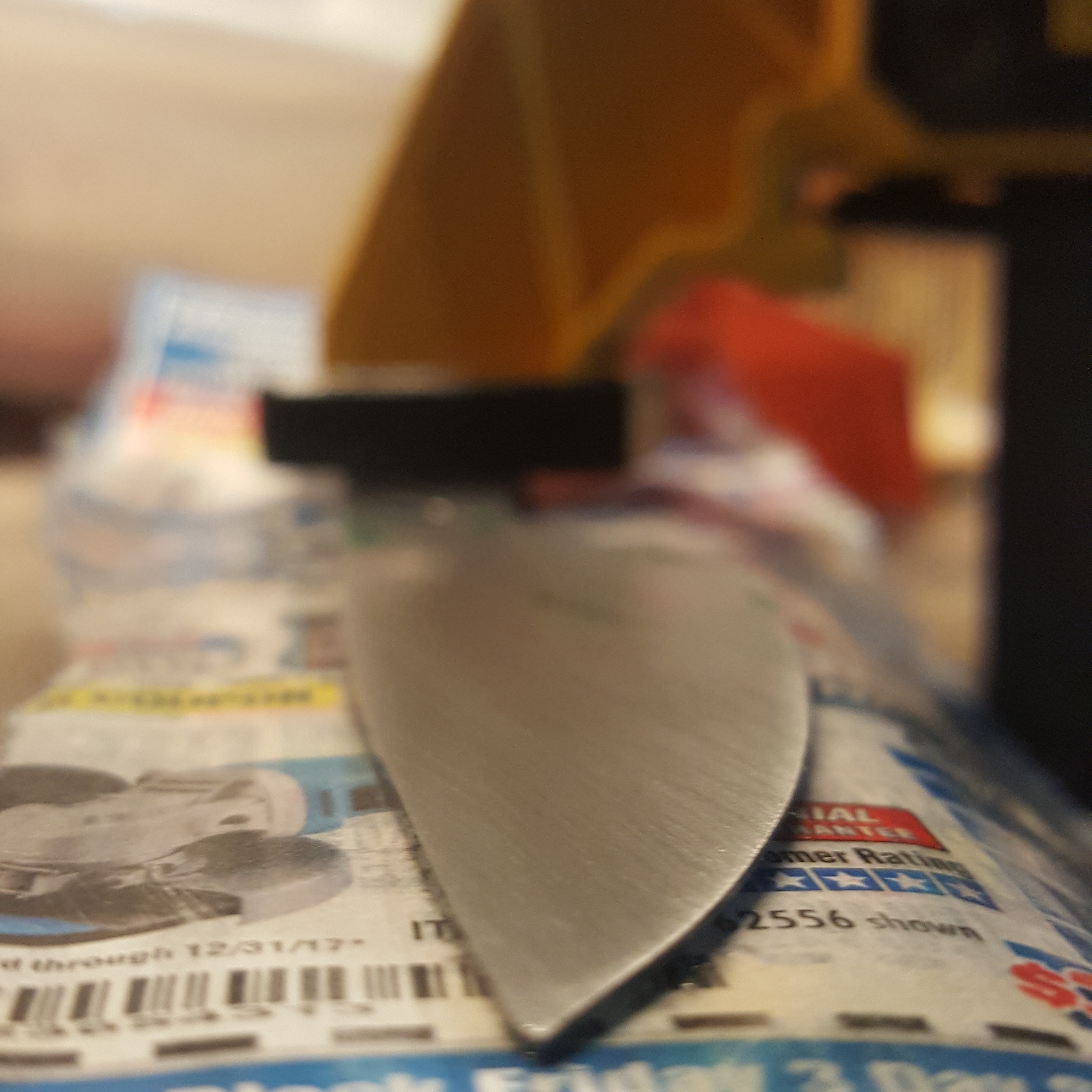

This is a knife with faults to be sure, but I'm pretty proud of how it turned out...
It started as part of a 1084/15n20 billet of Damascus I was trying to forge but the first weld only partially took, so I decided to try to make something from it! The handle is a wood from Belize that I can't remember the name of. Brass guard and pin.
So firsts on this one:
Forge welding, stick tang, partial tang, sculpted handle. (I thought it was my first fitted guard, but I did one before.)
Critiques please!
Here's what I notice: spine near the guard dips towards the blade, back of the handle seems to rise from the guard, flow isn't the best. Pin is too far forward, handle is too fat. grind lines aren't matching, grind lines touch the spine. Delamination on the blade. Blade layers are asymmetrical.
I'm sure there is more... please tell me what you think I need to work on the most!
On knives like that I would typically have the guard flush with the sides and top of the handle. Personally I find a washer guard to look a bit out of place on something like that.
I can see that, I wasn't really quite sure what I was going for with the whole thing. I think maybe planning things out a bit more would be good! Lol!

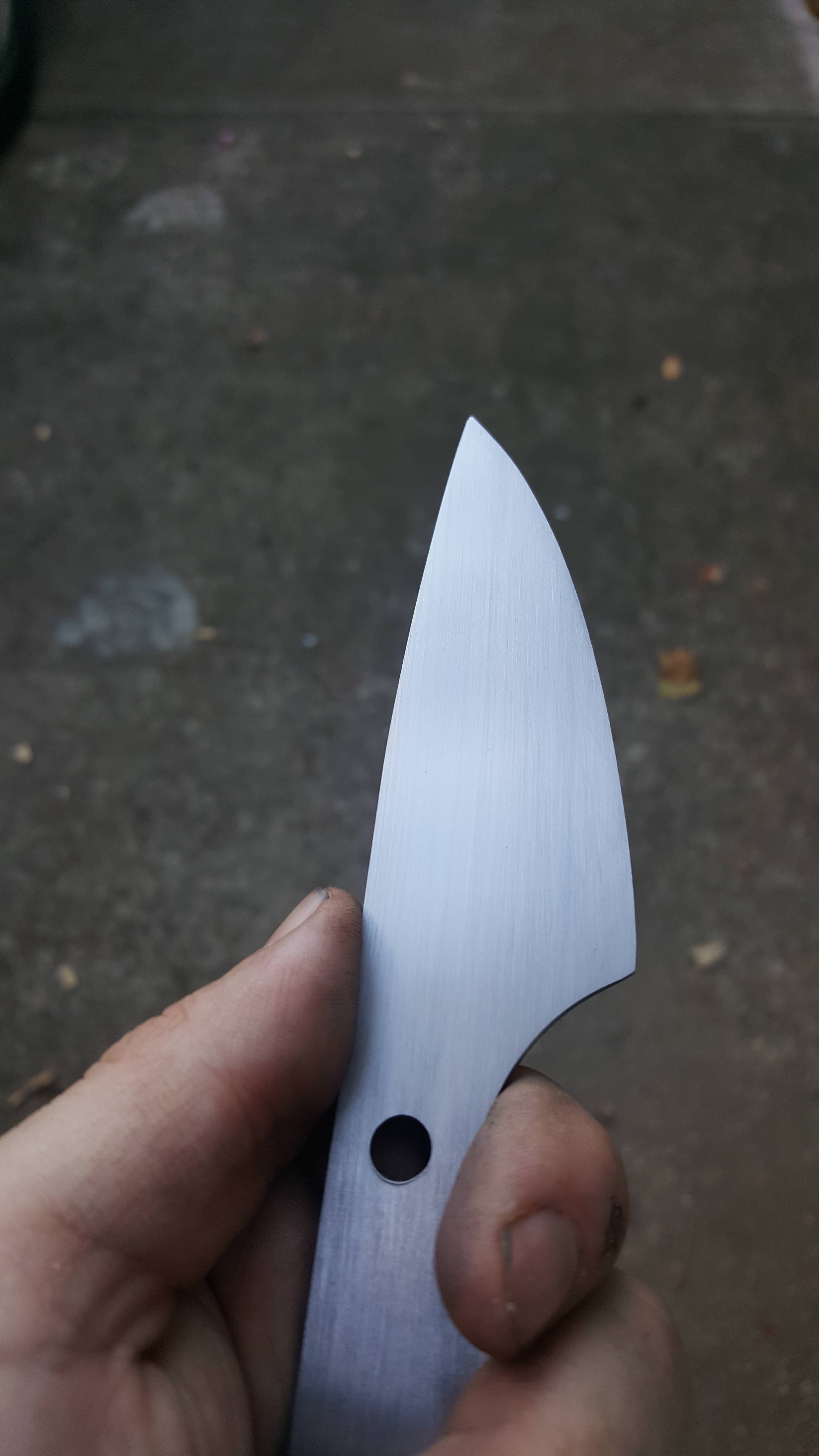

Well this is the furthest I've gotten with a knife. Never been happy enough to send them to HT. Idk how well this one will turn out. But it's hand sanded up to 400grit. Now I'm gonna send it off to JT for HT.

If the blank is ready glue it on and back together. I'd use g systems for the scales and liners but try to keep it out of the break, then use super glue there.
The thought crossed my mind, but I won't ship a knife with a broken scale. Also, this knife will have removable scales that are only sealed with silicon, not epoxied. I'll just make another set of scales.
