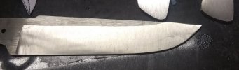

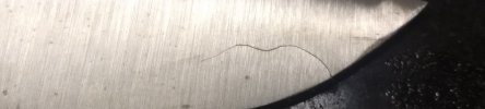

Been working on a lot of stuff. Got my shop mived, built a surface grinder attachment, and I turned the frown upside-down on this Nitro-V camp knife that showed a crack at 60 grit. I have no idea why. It looks decidedly shark-like and now looks decidedly non-Japanse-like. IMG_20180311_223523534.jpg IMG_20180311_223509775.jpg IMG_20180312_152737368_HDR.jpg

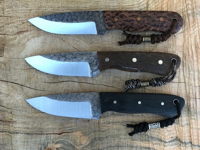

Just finished a Randall Alaskan inspired skinner. This is my first hidden tang, first antler, first bolster knife, and second one I’ve forged. It is 1084 forged from 1.25x.25” stock, left some forging marks on there too. Antler donated from buddy of mine. This is my 15th knife so far, all rest have been full tang. Learning every time
Just finished up these. Nesmuk is D2. ended up with the Nesmuk style because it fit my odd shaped piece I had. 3 3/4 blade g10 and Corian countertop

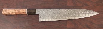

"ghost cloud" pattern in a v toku2 core s.s. clad petty. this one about 180mm.
Danf, is that silver wire in some kind of horn?
Silver wire in curly maple stained dark brown, surface sealed with super glue, dried, then edges sanded to almost bare wood and stained light-medium brown trying for an aged look.
