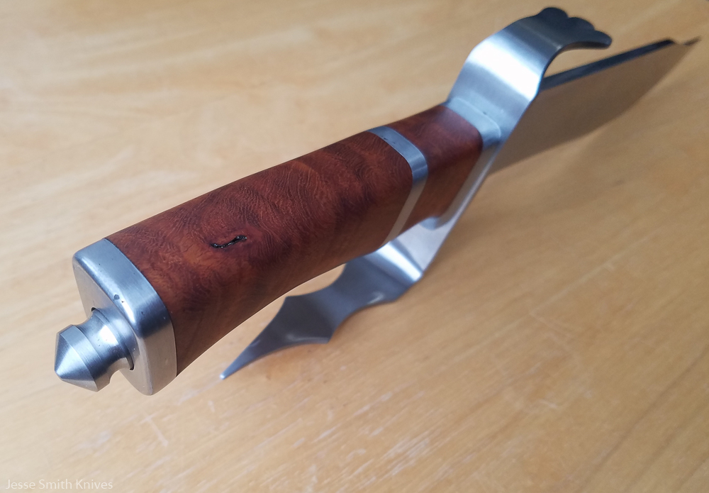

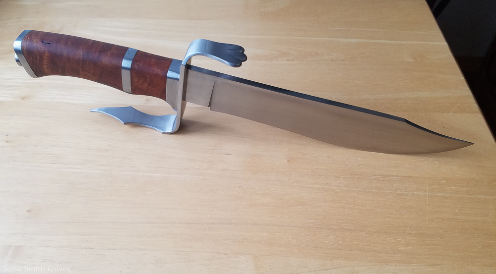

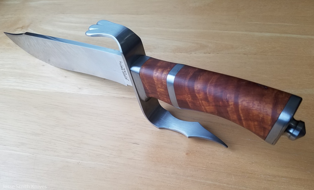

Just finishing up this one. This represents a LOT of firsts for me. It's my first Bowie, first S-guard, first take down, first time working with wrought iron, and it's the first time I've made San Mai.
It's a 1084 core with 15n20 jacket San Mai, wrought iron fittings and ironwood handle. I'm kind of proud of the pummel/tang nut, considering I don't have a lathe. I tapped a hole in a piece of wrought, chucked a piece of threaded rod in my cordless drill, threaded the wrought onto the other end of the threaded rod, and turned it on my grinder, and cut the groove with a file while in the drill.
Still have to etch the blade and fittings.

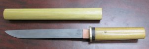

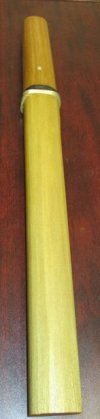

I FINALLY finished the traditional tanto I've been working on. Thanks to Stacy, HSC, Greg, and many others who helped with advice. It's not the best hamon (I've learned a lot and have a ways to go in that regard in a year). Blade is 1075. I started this thing over a year ago and would work on it for a few hours and put it down over that period. I have a renewed respect for all the hand work that goes into something like this.

I can't imagine how I helped you on that, but it looks great, nice work.
Might have been someone else. I had a lot of advice over a long period.

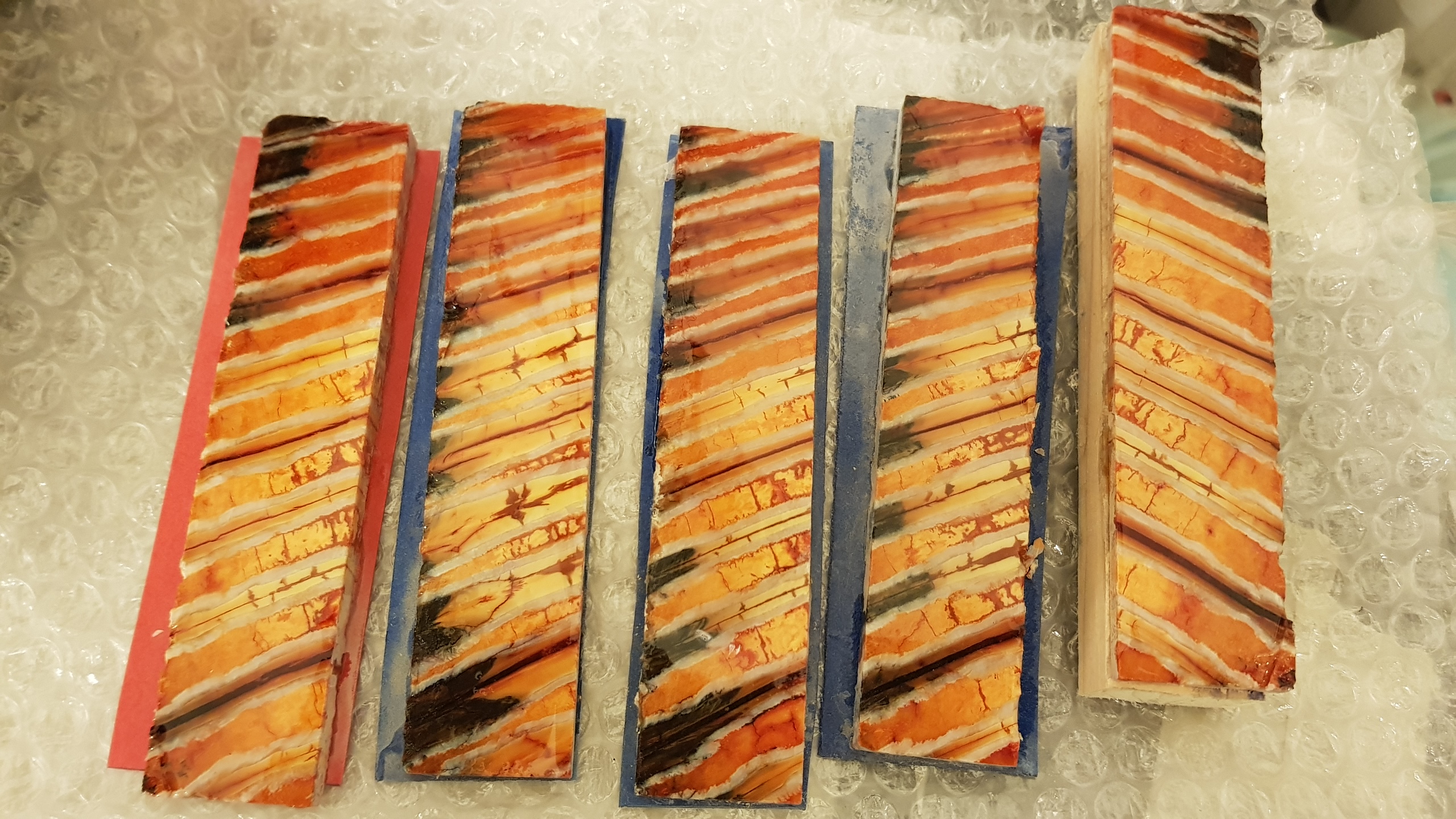

Finished a batch of mini EDC blades i'm calling PocketPoons because it makes me laugh. Anyways finished these recent ones up with some special handle scales from DerangedDonkey. It's a burl hybrid wood with acrylic mated against the live side of the wood forming a sort of natural bolster. I also had to have some with shredded cash in it. I don't know what my problem is, I have a huge ***** for shredded cash scales lol.
As you can tell the middle knives have a much thicker edge than the outer two cash knives. I get these ideas that some people like performance driven tools and others just want bomb proof. I try to make both. I don't know lol
