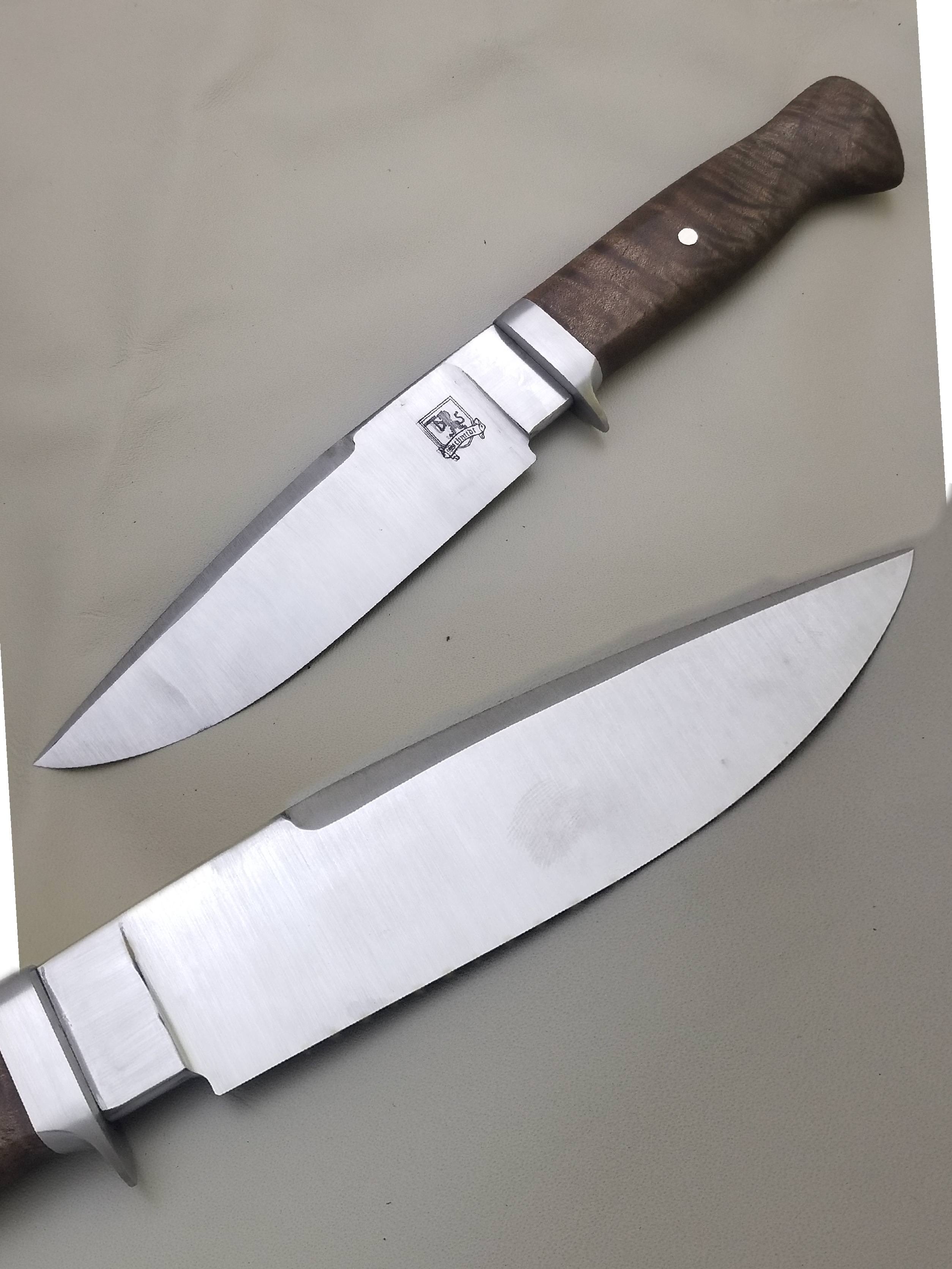

Just sent off a few to Peters' in AEB-L. The three 3" blade drop points are for our Medical department, will receive natural Canvas Micarta scales. The Santoku is for my father, ground for a lefty. The little guy...well, that's just cause :)
Finished up a little kitchen knife that has been waiting a while. 15N20 steel from JTKnives and burl from Kevin McGovern. Thanks Guys! First time working with stabilized burl, what beauty. It cuts jalapenos pretty well too!
