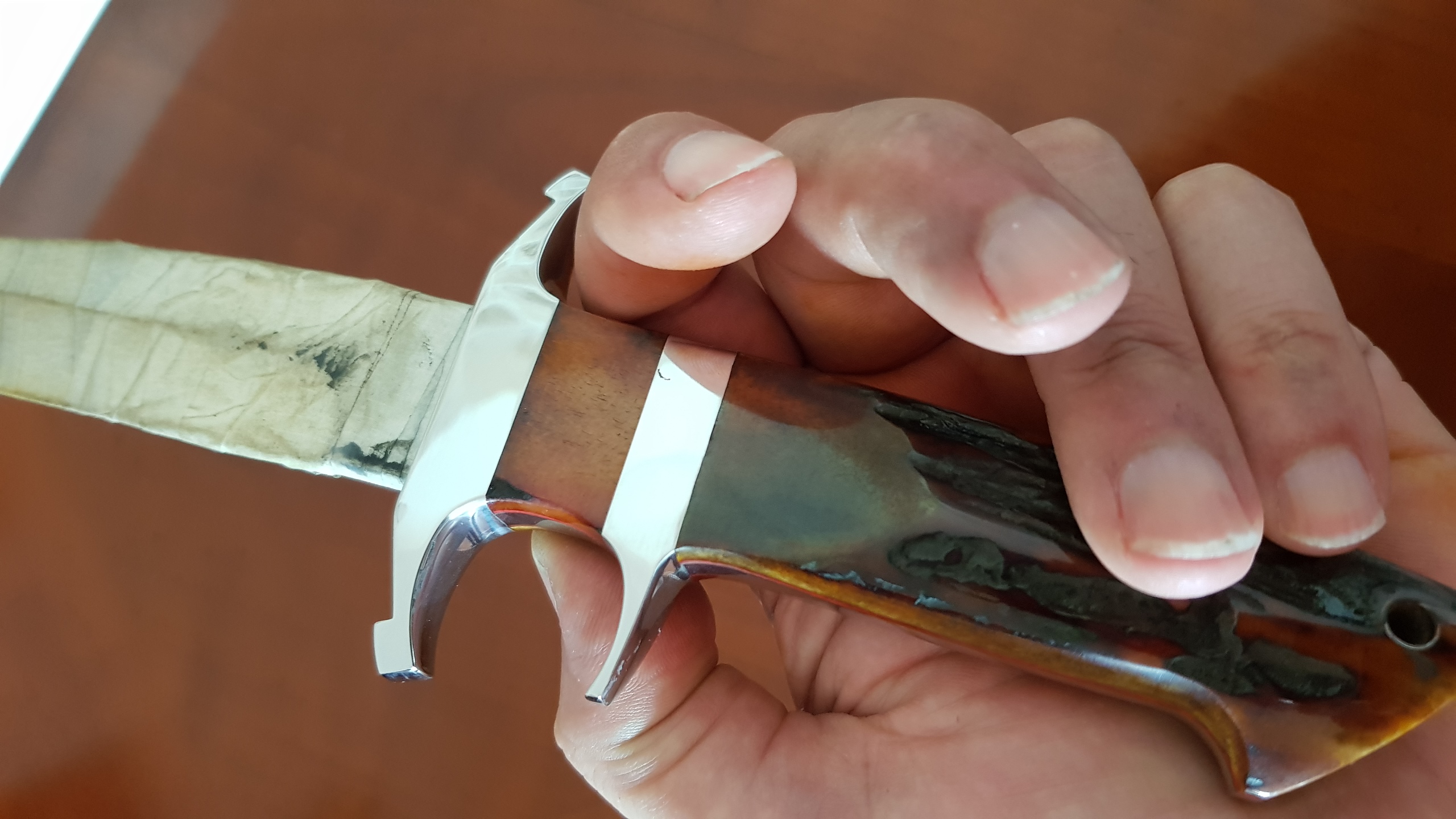

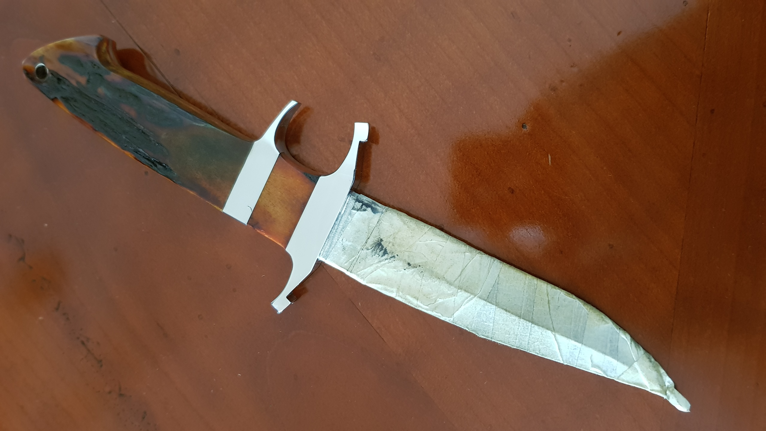

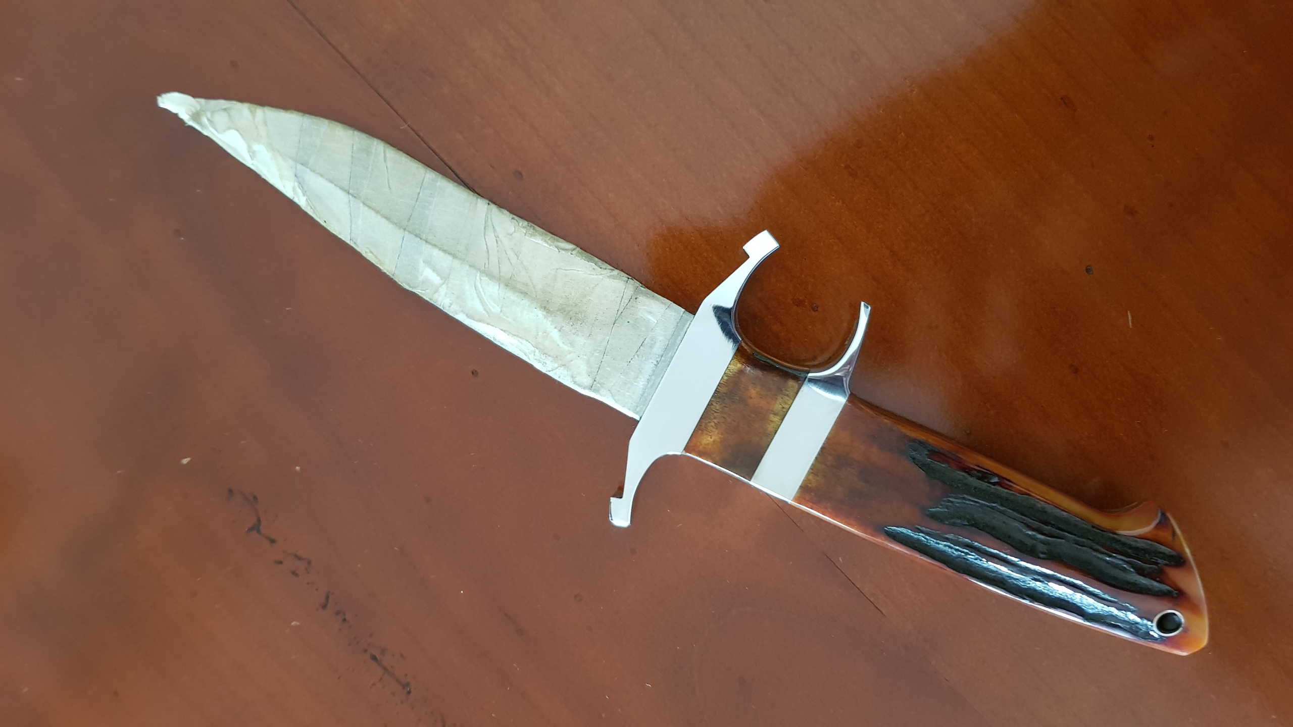

An 8" Buie.... (the old spelling).
Scrap 5160, scrap stag crotch, and fire blued scrap (soft - 1016?) steel.

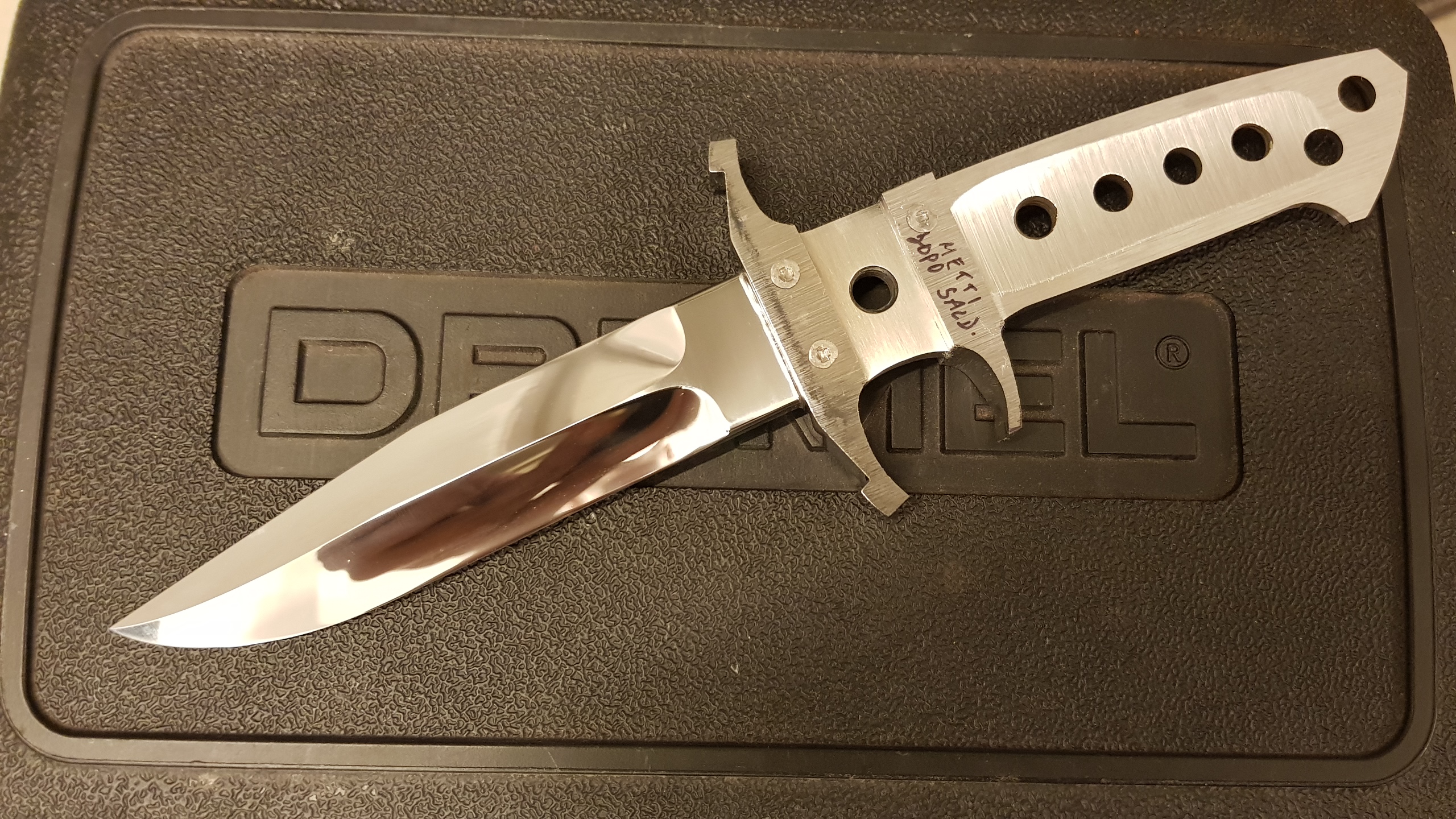

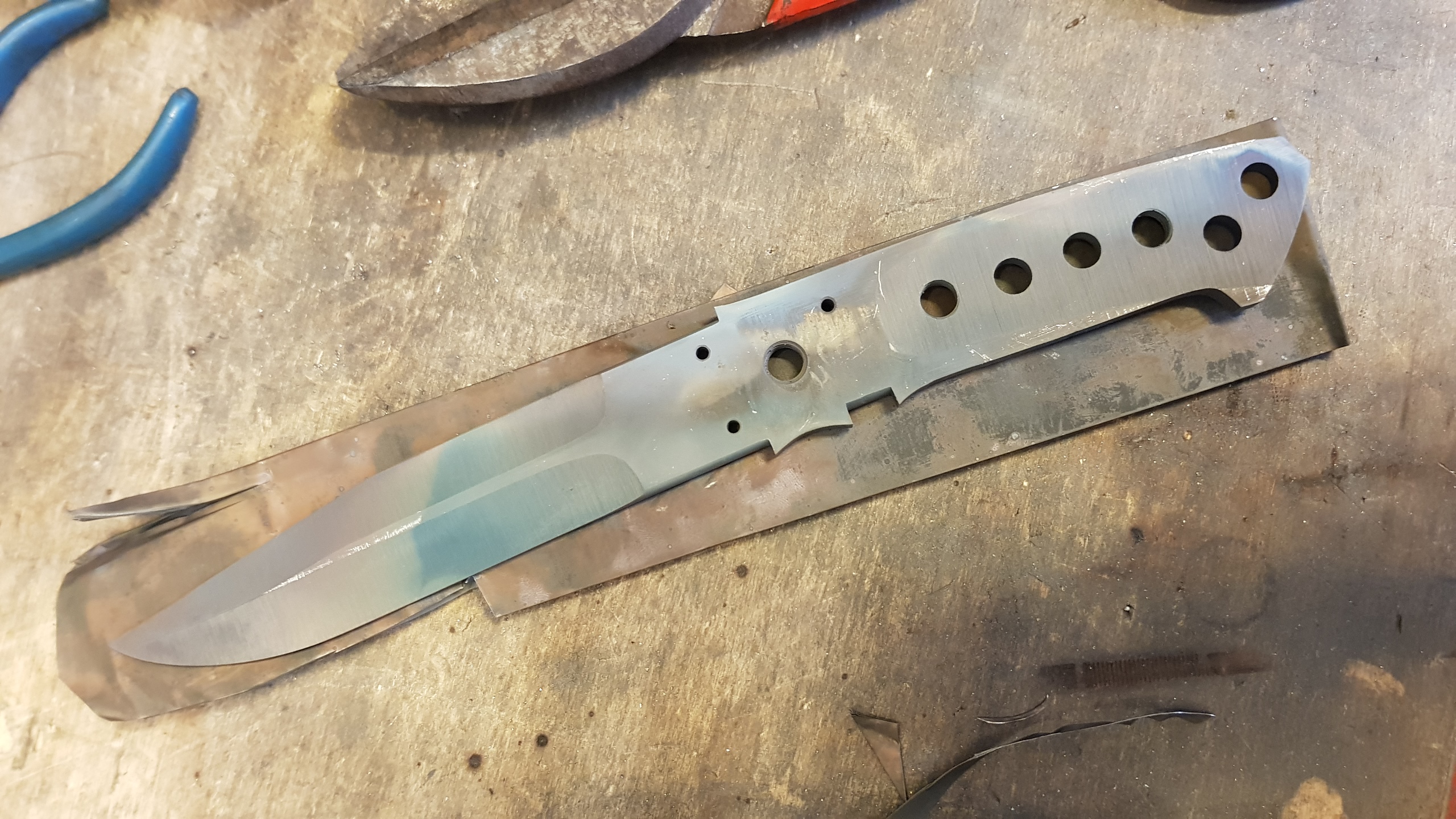

I've got to stick some pins in it, and make a bomb escutcheon but it's fun to back making something. I like driving the guards on, and using no adhesives. Tricky. But they did it every day in mid 18th Sheffield.

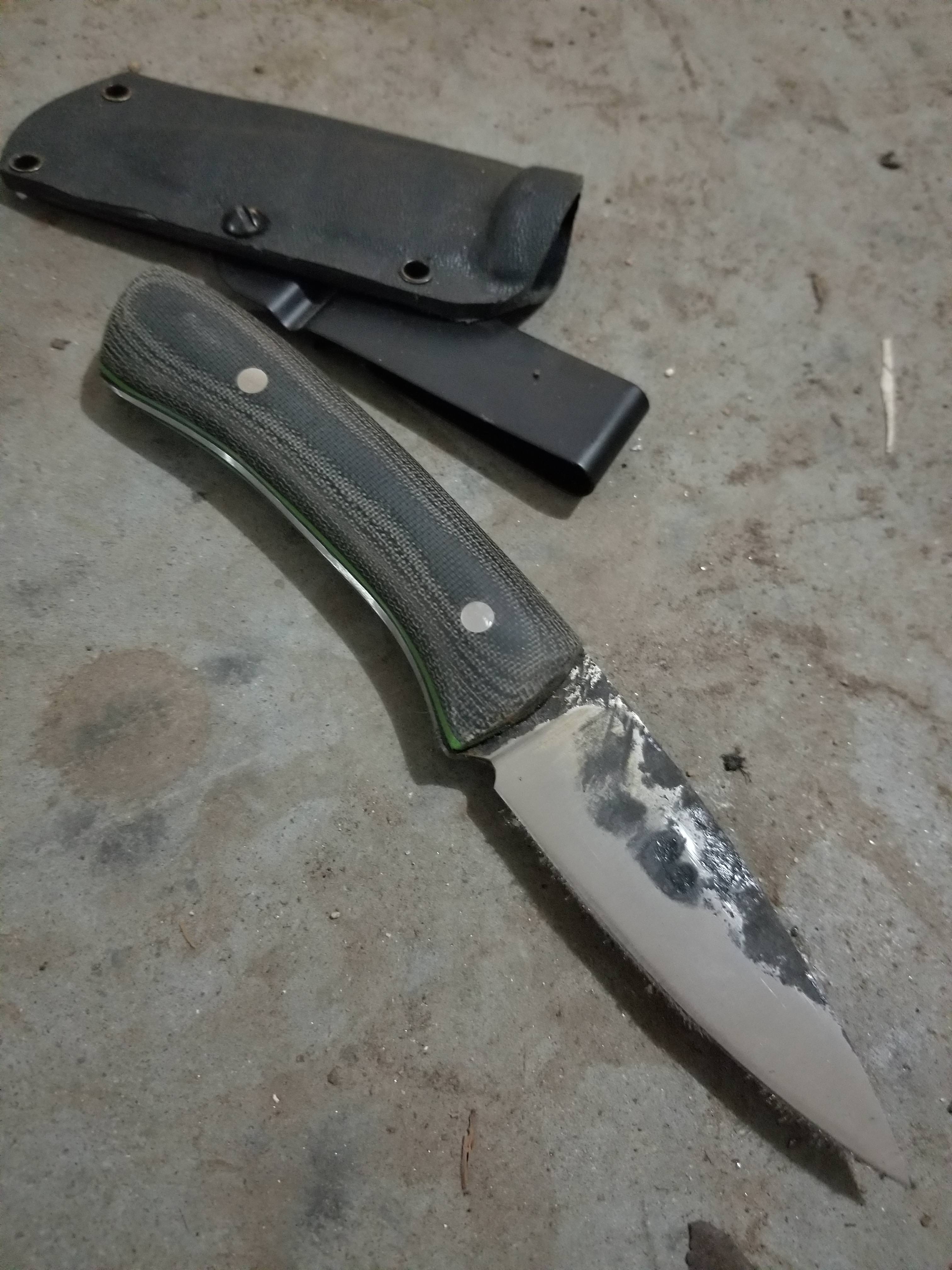

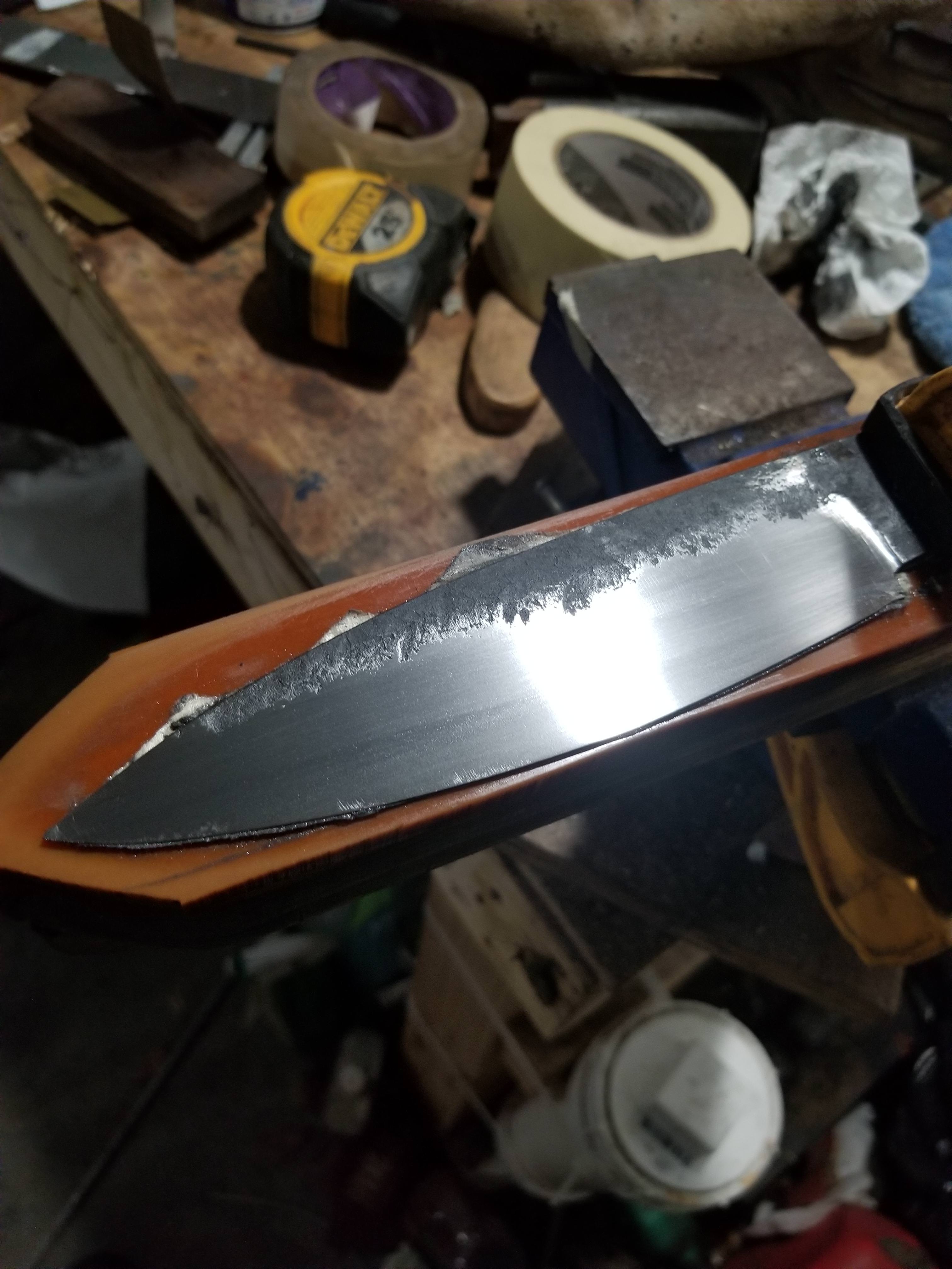

Here are two works in progress 80Crv2. One is a little box cutter thingy that was an afterthought with some left over steel with burlap micarta on top of toxic green G10 liners. The other is a wharncliffe with canvas green micarta which I am really like after this one.
Maybe a stupid question: what’s/how did you make that finish on the blade? It looks great!
Looks like a stone acidwash to me, I'm guessing he used Ferric Chloride and a stone tumbler. I've done it myself with Ferric Chloride and a nalgene bottle filled with little river rocks from the backyard, very easy and fun. Go for it!
Ignore the scratch on the bevel :)
