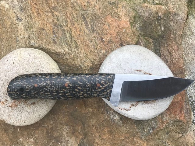

I'm working on this two little drop point hunter: blade in Bohler N690c &bolsters in AISI416

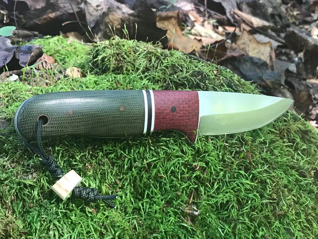

Etching and gluing up a 15N20 hunter/skinner. I have been very pleasantly surprised with how stable 15N20 is in the quench. I have now filed down two blades to between .01 and .02 behind the edge and a pretty tall flat grind on one. They both came out of the quench straight. What I had to learn about this steel is that it work hardens! Even filing the bevels I would get a crust every now and then that would start skating my file, especially at the tip where it got thin and my filing was making it the hottest. Same with drilling, lots of oil and small bites.
I share your experiences with 15N20. I got mine from Alpha and it comes harder that other carbon steels like O1 and 1084. Drilling was very difficult. I also like how well blades come out from quench.
This last time, I heated it to 1200 in my mini kiln and then let it cool slowly. This made machining much easier.
