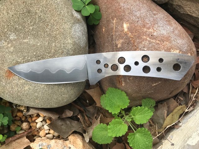

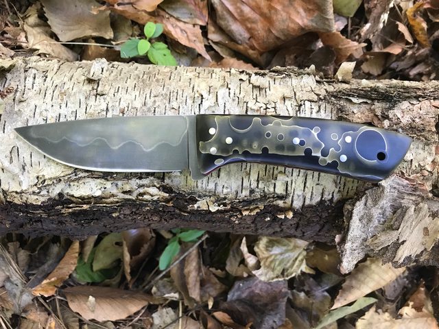

bike4fun919, very nice. Any tips on how to do that, the blade I'm working on right now is also 1095.
This is my first attempt, so take that with a grain of salt :).
I used my Evenheat oven and soaked the blade (I had the grinding about 80% complete) at 1475 degrees for about a minute. I used refractory cement (thinned) to coat the spine. I quenched in Parks 50. After tempering I did the finish grinding. I hand sanded to 800 grit (took almost three hours). I used WD40 up to 400 grit and then used windex up to the 800 grit. Then I used the widex and a grey scotch brite pad until the finish looked smooth and even. Washed the blade in hot water and dawn several times and used a paper towel to dry it off. Then straight to the etching solution for about 20 seconds. Took it out and rubbed it down with a rough cloth towel. I repeated these steps about three times in the solution, 15 sec, 10 sec and 5 sec. (all approximate) rubbing the blade with the towel each time. After that I sprayed it with windex, washed in off in clean water and used a really fine honing paste to polish it up. Hope this helps.
