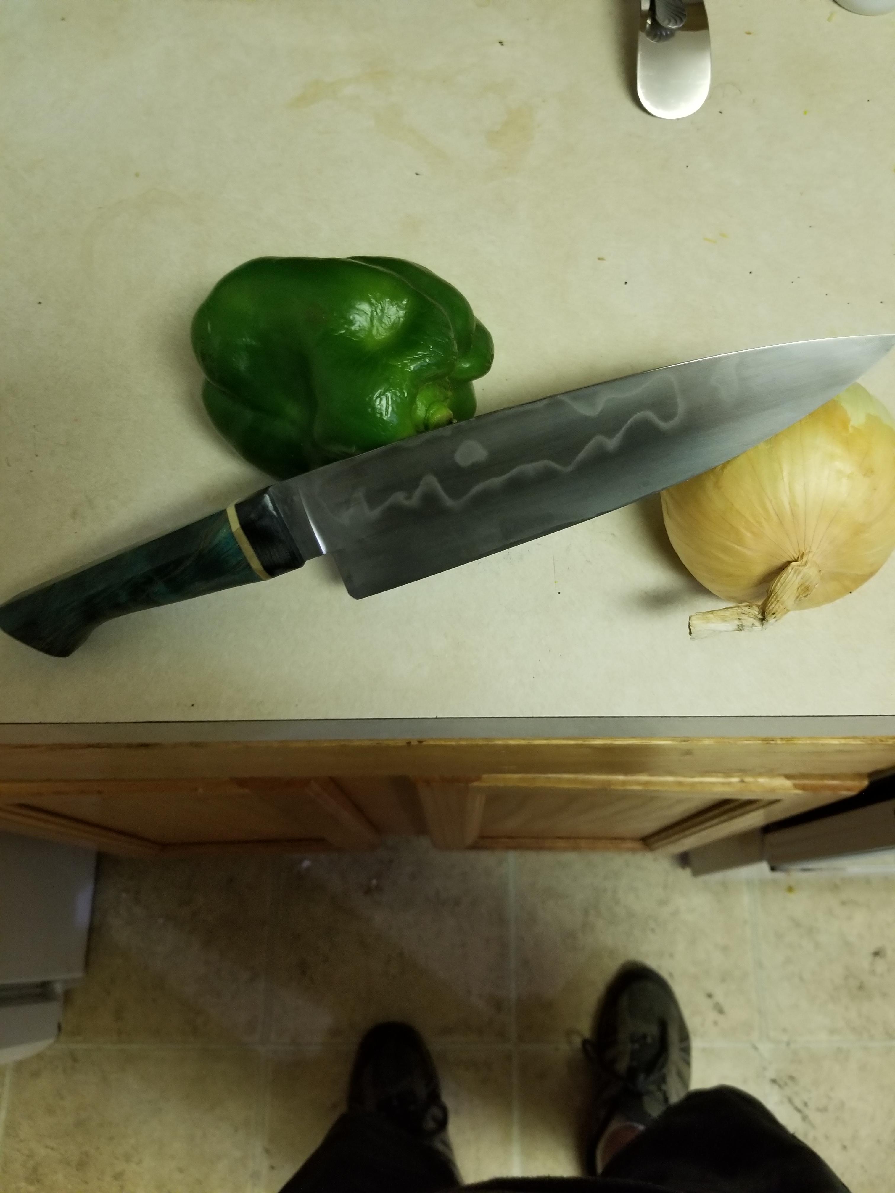

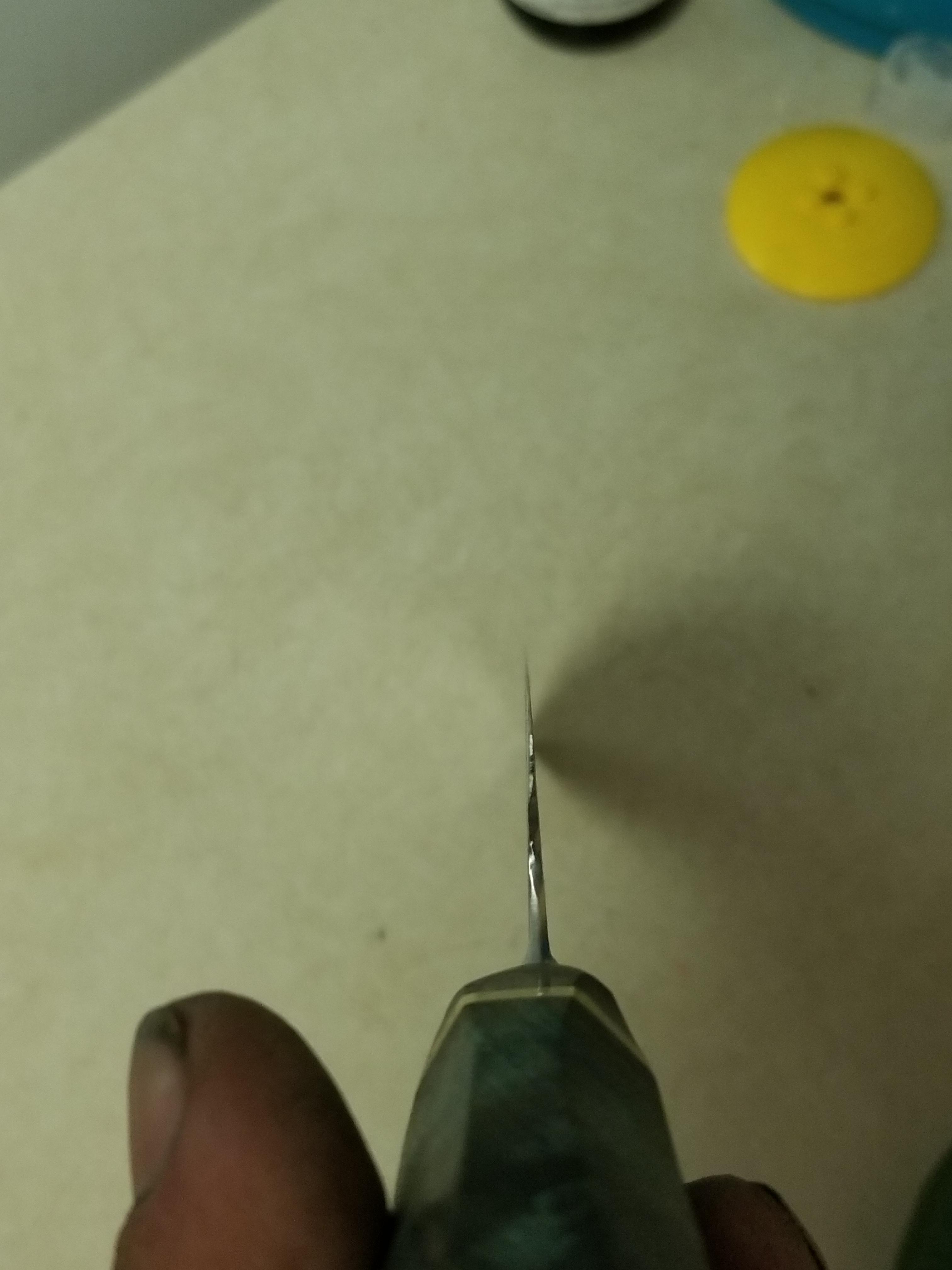

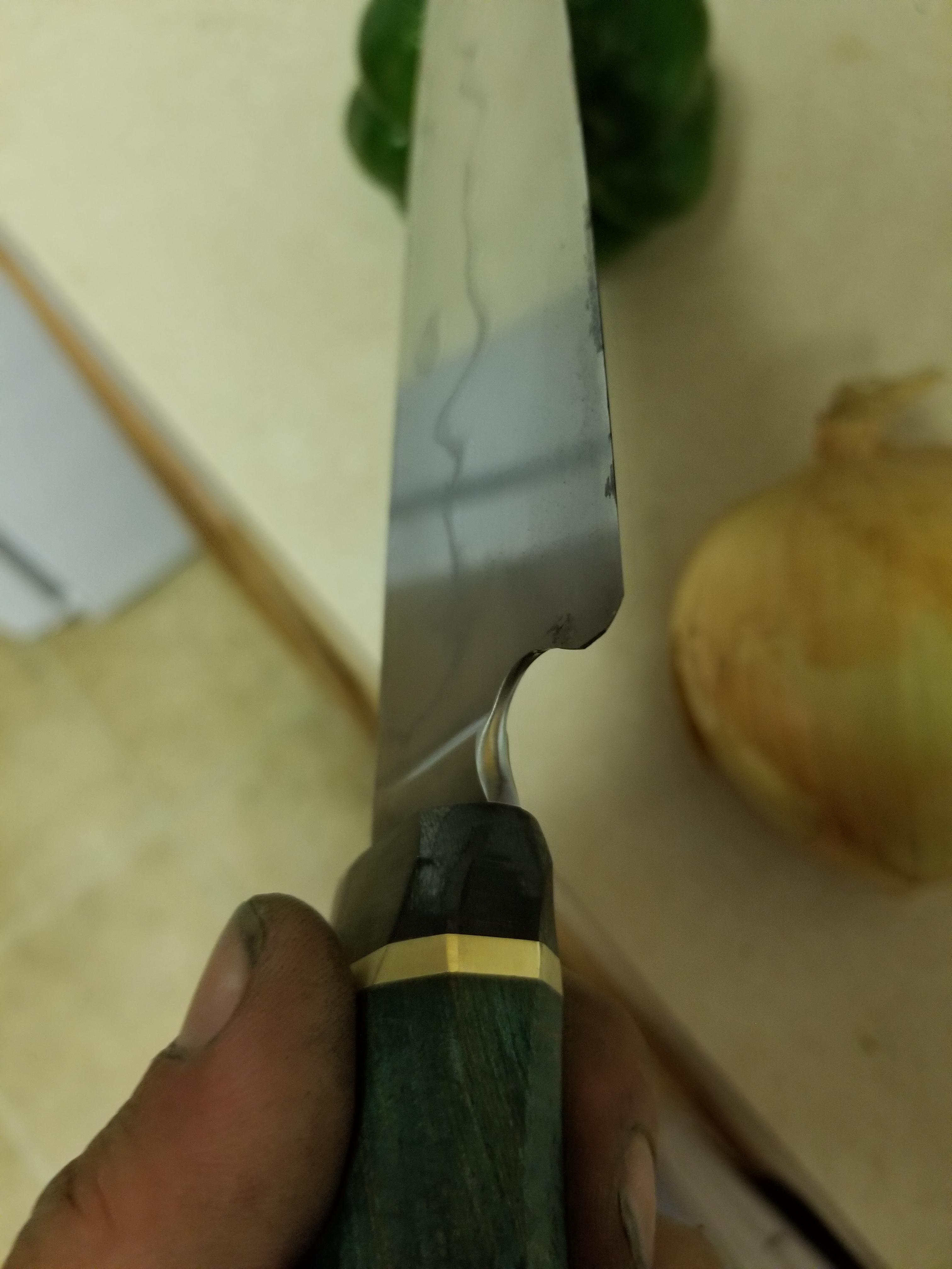

Tried my first piece of 15N20 on a k-tip double-ground kitchen knife, tried to harden it after grinding in my tiny Atlas forge, ended up with a kris cousin....:
So I ground the wave out of the edge, re-ground the bevels, and re-hardened (thicker at the edge), only to have it reappear on the side! Now I'll NEVER get it out! :p
