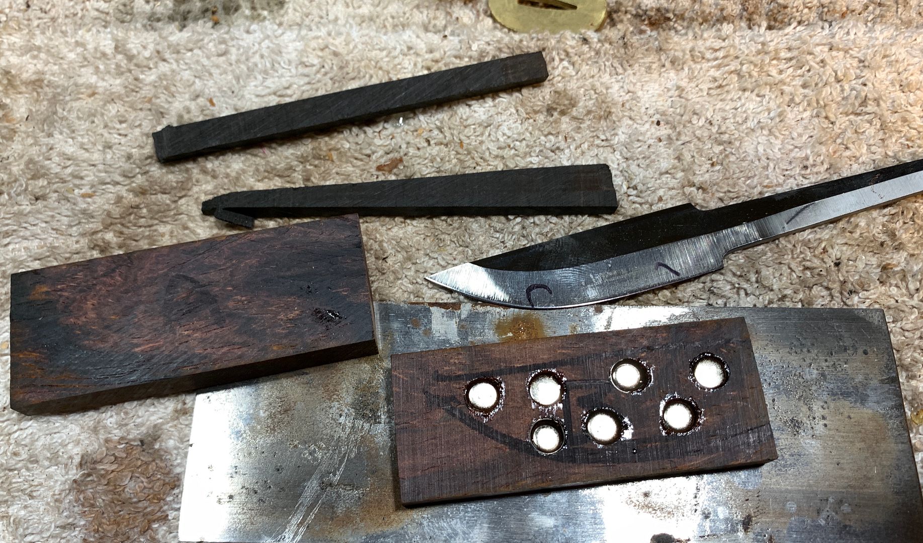

Always 7 magnets. I set them below the wood surface then fill with vaseline. Makes nice swooshing clicking sound when the 1# magnets grip

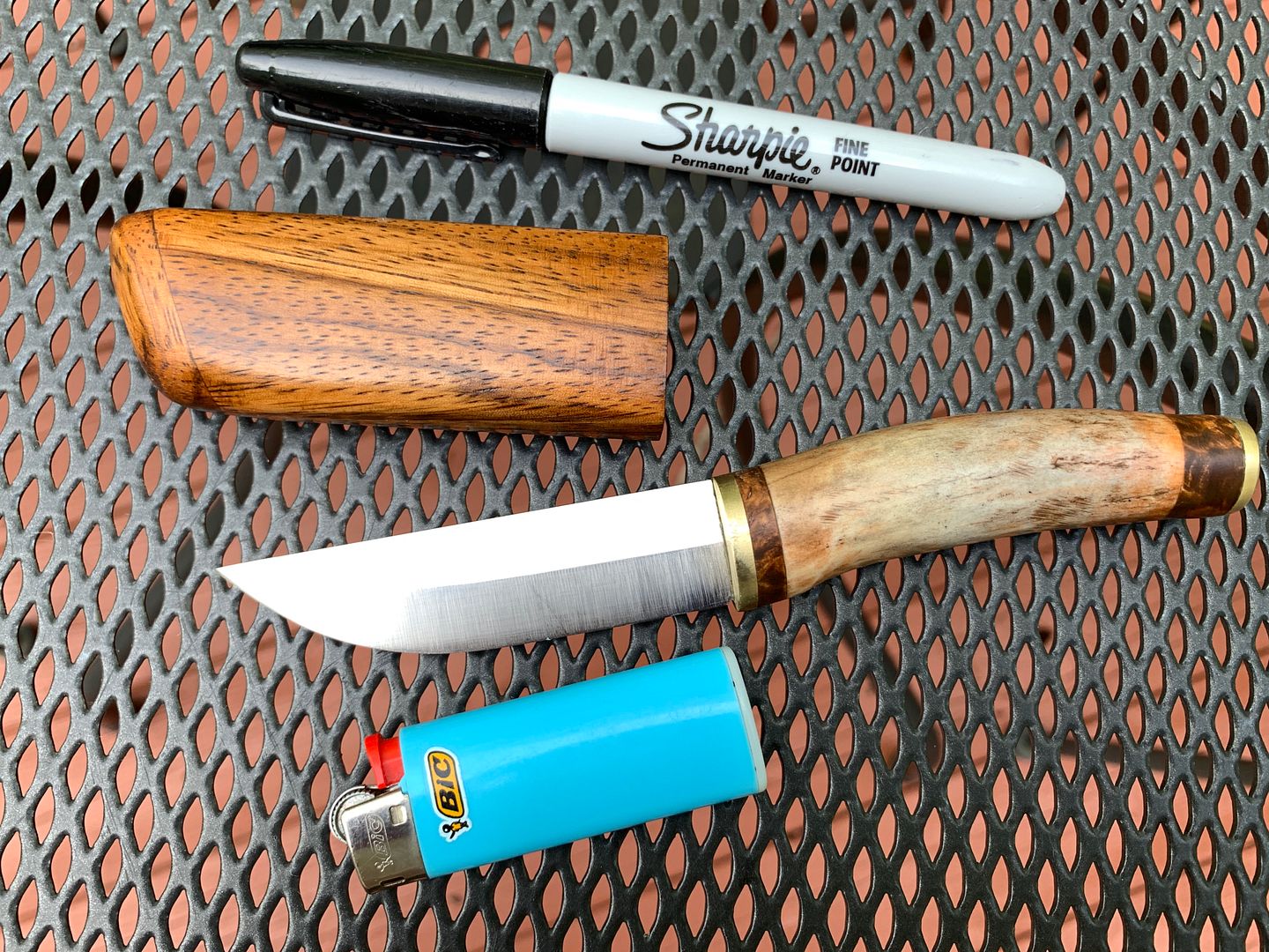

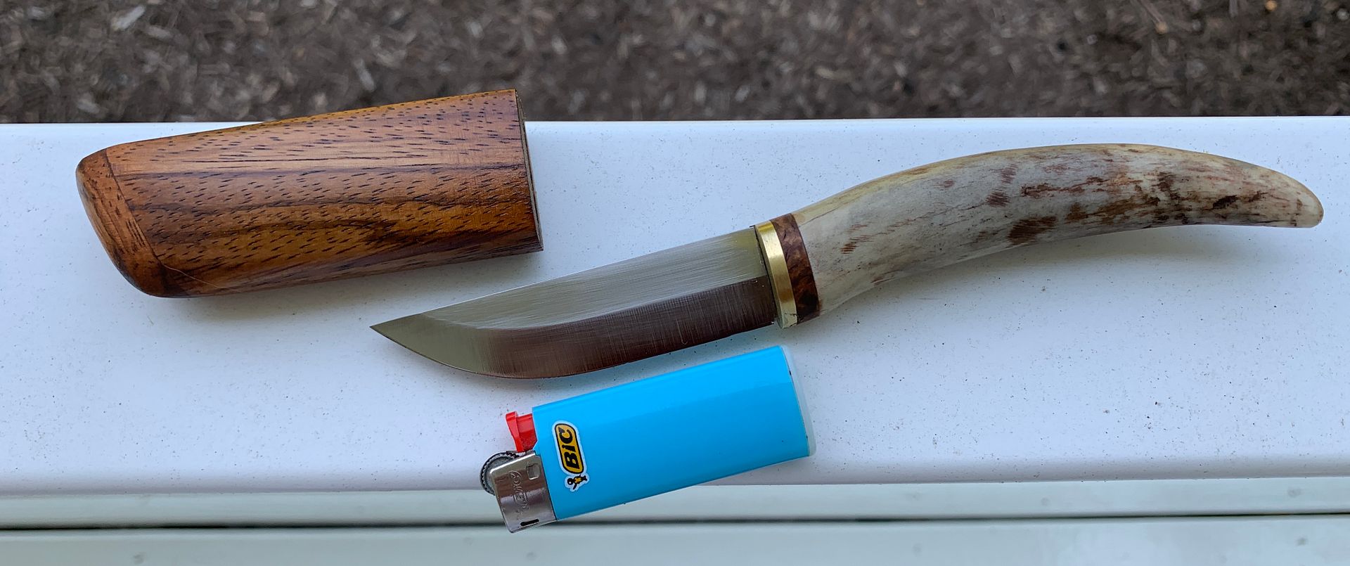

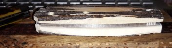

Blade is just under 2.5”. Making myself another pocket fig pruner

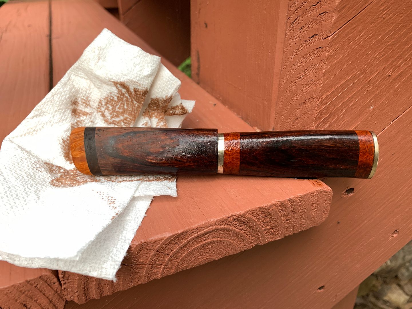

The cocobolo is a little too purpley for me, not that there's anything wrong with that, so I’m darkening with water soluble dark walnut. Hitting the amboyna pieces a little darker to blend with the cocoblo
I think that I will make more like this one . . .now I like horn :)

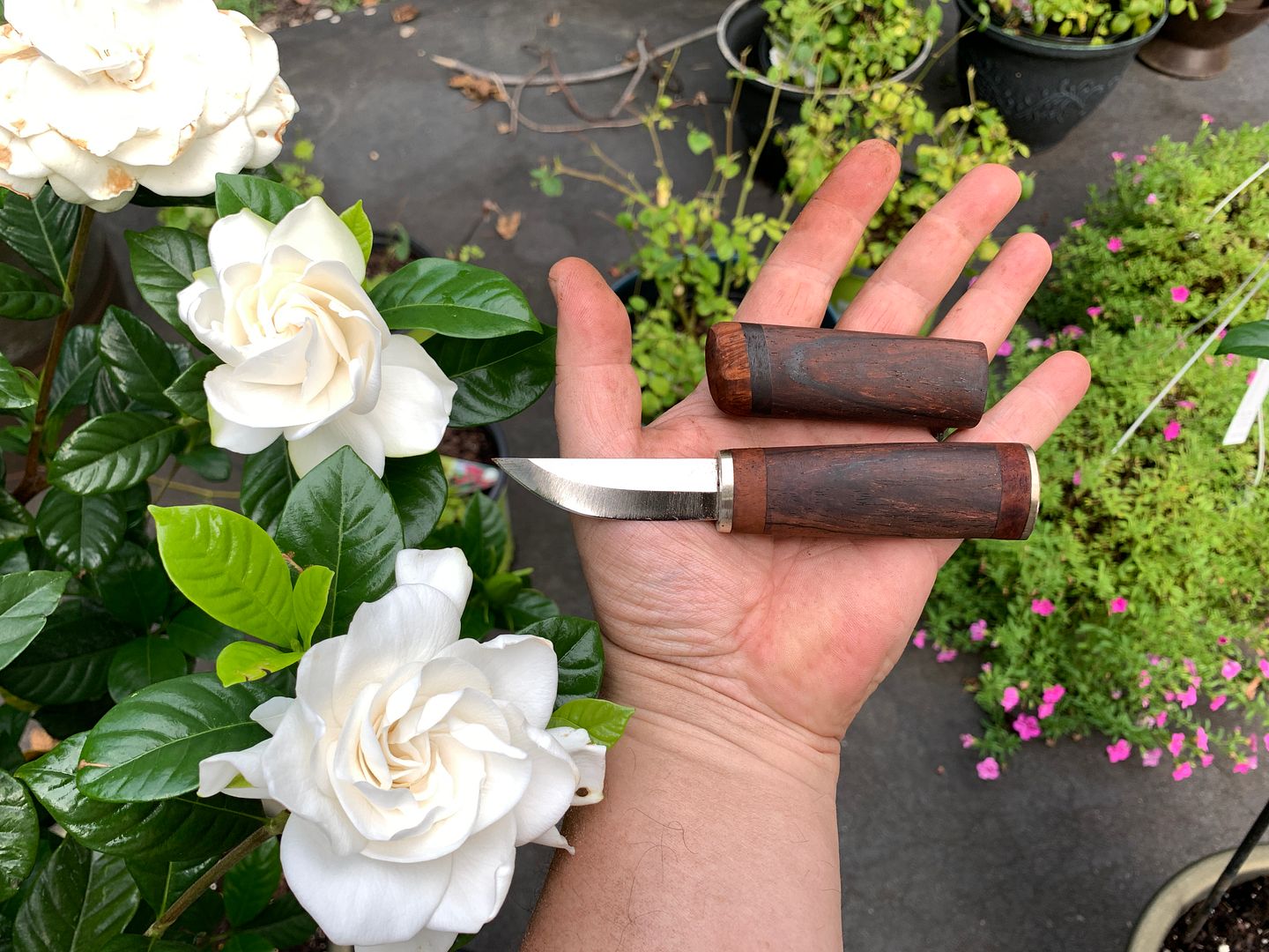

3 more Pocket Puukko’s came off the bench last night in the middle of Hurricane Warnings and torrential downpours. Took a brief nap during a 3 hour power outage.

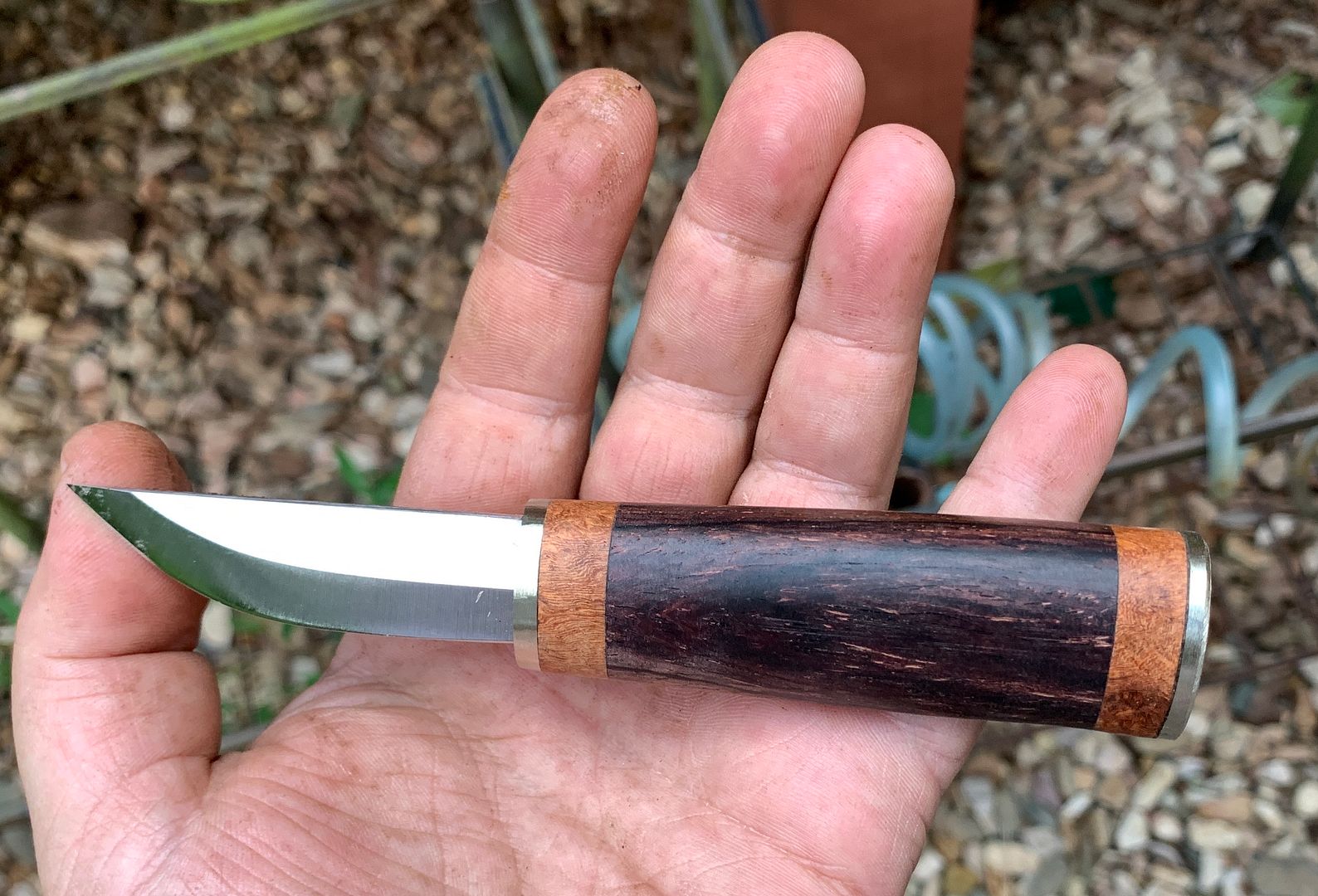

2.5” Scandi Grind in Cocobolo, 3” Scandi Grind in Hawaiian Koa and 3” in Bastogne Walnut
