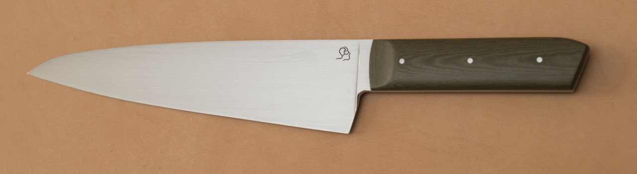

a little break from kitchen knives to work on a utility hunter order, so start with a tapered tang, hardened Z wear
VXXLtPS.mp4
Do you always drill the pin holes jus a tad above handle center? I know you mentioned it to me regarding kitchen knives.
Experimenting with 14C28N. First time I tried it. Have to tweak my HT a litttle, got 60 Hrc but was aiming for a little more. No warp though, did my best to avoid that. This is my second attempt at a "large" chef knife. Lesson learned from the first one: remove a Lot more material. So I ground this one flat to 0.0039", no edge yet obviously. Tried to taper the thing. Gave it a little recurve on the spine. Lesson learned on this one: grind cool and carefully. I fried the heel a little, hence its rounded appearance. Hand sanding? No way I'm ever doing that again. Just finished to Gator A45 on a wheel, longitudinally. Gonna do a little time travelling back to the 00's later and put orange scales on it.
Scaniaman - looks good. My guess is that once sharpened you are going to really like that edge and cutting action. I can’t get below something like 0.004 without water cooling (still need to get that) ... and I also start having trouble with pullouts (not sure if it the steel (carbides?) or too coarse a grit for that edge thinness...
I saw that comment, I can't recall that it was me who said that though.
anyway, just the middle pin, slightly forward and high of center, but very slightly.
in this specific case, I've never made this knife pattern before.
but I'm pretty certain the holes are on center, could just be the camera angle that make it look otherwise
