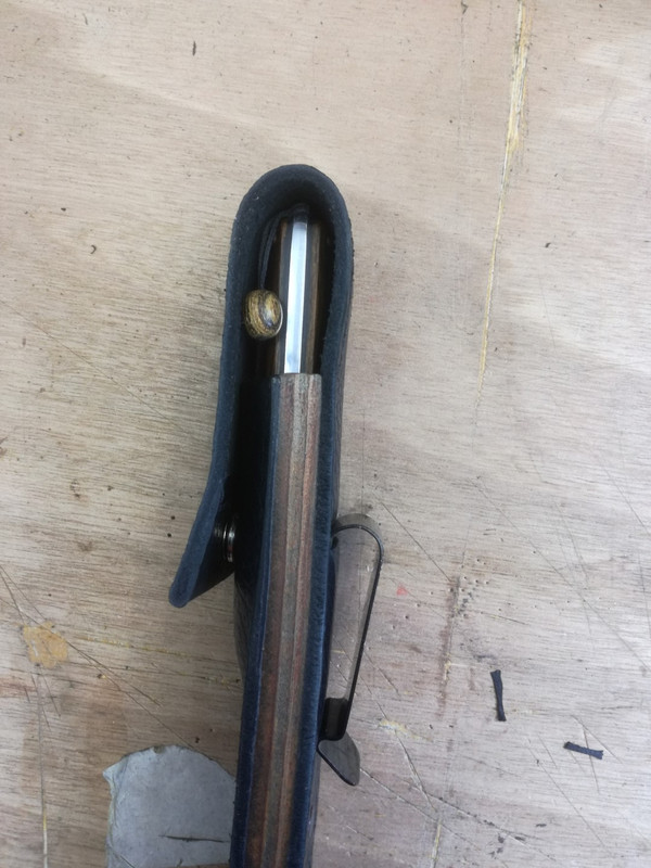

Thanks! That’s a neat package.I usually make small to medium size fixed blade knives and try to make them sheeple friendly.
Here's an idea to keep and carry such a knife without people immediately noticing you have a fixed blade on you.
It takes the knife edge to the left or to the right so you can wear it inside a pocket, outside your clothing, left handed, or right handed. It also has a clip that doubles as a belt loop. Wear it inside your jacket, in the front pocket of your pants or on your belt, it's all possible.
I had some nice thick leather from my former dayjob. Here I thinned one side from full thickness to paper thin.
So you can fould it double without getting thicker.
And it takes the upper half of a magnet closure(correct term?) without it showing on the outside.
(and it shows the clip I used)
Here a test piece: I removed enough material for the leather to take the clip without showing it on the outside or become thicker.
The clip is in the leather.
Here is the inside. I removed material in two steps. The large square to cover the clip on the inside and the smaller one, deeper to accept the clip.
Here you go a clipped sheath without becoming thicker.
Just a sleek and discrete black leather case, nothing screeming knife.
And it holds a ~4" fixed blade knife.
