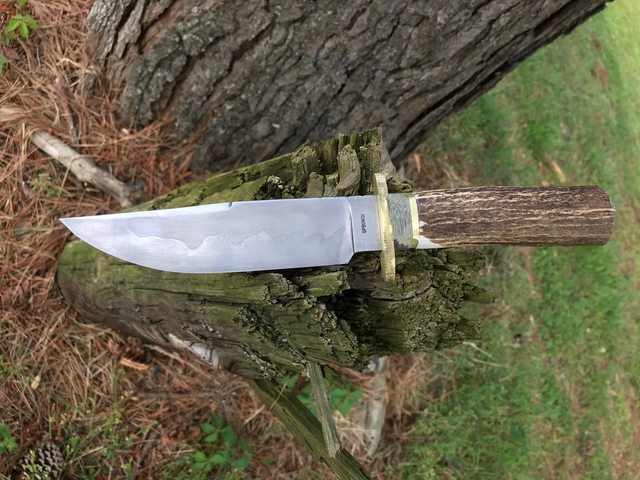

1DABBBBD-7123-46C5-B6B0-557D67F5B522 by Wjkrywko, on FlickrI have some questions:I visited a friend some day ago in his machine shop to steal from him some HSS if I canOne of his workers ,also my friend.............was trying to make knife from HSS steel with angle grinder
I barely persuaded him to give up and give to me that piece of crap to make something for him
So here we are................ he didn't even notice the crack there
From this .....................
To this ...............3.5 inch hollow blade in 3.5mm thick HSS is max. what I can done .I don't think he'll believe that this was made from his piece .......
Of course, the visit paid off............I m good in stealing HSS
5mm .....M2
This MF glazed many times mu cutting disk
drilling 8mm hole in 5mm HSS was fun
I have some crazy plan for handle ..............
All data was laser stamped on saw , Fredy Cro. My friend use HSS saw from wittmann-komet....I have several in M35 and one in M42 HSS...they are quite expensive....over 1000 Euro piece depend on steel ,size , thickness and coat .Particularly this one is Yougoslavia made ...........more then 30 years ago.I have some questions:
How do you know of which hss steel the disk is made of? What are mu cutting disks? How do you cut that disk without overheating? Will you temper the blade or use as is? How is hss in terms of rustproofness?

OK, so good, expensive saws will have the info stamped. Good to know, when I am in fleah market next time..All data was laser stamped on saw , Fredy Cro. My friend use HSS saw from wittmann-komet....I have several in M35 and one in M42 HSS...they are quite expensive....over 1000 Euro piece depend on steel ,size , thickness and coat .Particularly this one is Yougoslavia made ...........more then 30 years ago.
Cutting disk i use are 1mm thick.....best one I found to be cheapest one .This is first time I cut 5mm HSS ...hard work !Cut .......stop.....cool....dress disk....cut ...stop . This one glazed edge on cutting disk many times...I use diamond to make them cut again.With 3mm ,2.5mm no problem , I cut them in one move .........no heat at all .
No temper .Rust......they are better then simple carbon steel.M2 will rust .M35,M42 are far more resistant .....I call them stainless
Fragile stuff........but they would stay sharp/cut long time in right hand![]()
