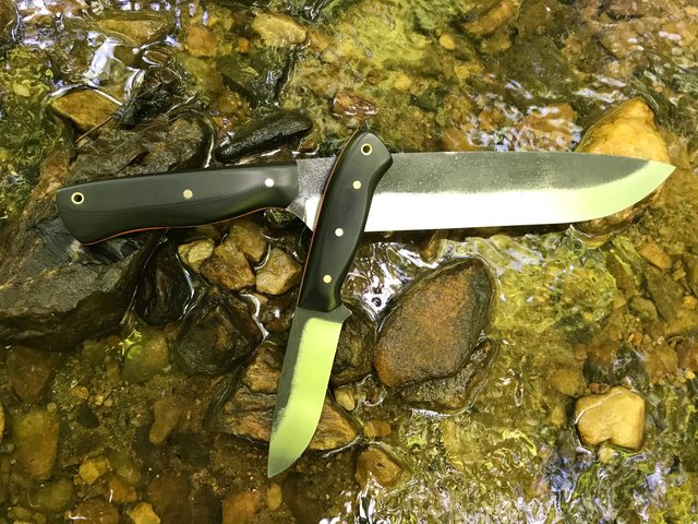

This is a very appealing handle style, I like it much more than traditional Wa.
You have some wicked takes on this craft, keep em comin :thumbsup:
you know this handle style is totally my take on a Mareko Maumasi handle, I wish I could say I had some innovation here but it is really all his style
Pretty. I like the funky front of the scales ... and I would not have the courage to try what you did with the finger slot, or the filework. Got a fourth knife? Wow.
(only one question: no sharpening choil? Personal preference of mine... otherwise things get funky after a few sharpenings...)
Thanks! I will add the sharpening choil with a small diamond burr on a dremel, I was just lazy :) Finger slot I started with a round file and finished with a half round file, not perfect, but it feels nice. I actually didn't clean up the jimping (done pre ht, started with a hand saw and then widened with a dremel with cheap diamond burr, was actually quite easy once I managed to hold the dremel straight).
Mistakes:
- my hand slipped when I was flattening the flats after I did the bevels (can be seen on one plunge/ricasso area) - lesson, do pre-beveling, dont touch afterward
- shortened the front of the scale too much - lesson, measure twice, cut once
- needed to readjust front of the scale, mared up the ricasso area - lesson, cover ricasso area better, try lacquer technique
- put too much daenish oil and left it there to cure, gummed up the handle - lesson, wipe up the excess on the hardwoods, it won't soak up
- hidden loop hole off center, drill slipped - lesson, big center punch, start with a smaller drill to center

O1 tool steel blade/crushed shell resin handle.
Critique away...
Hey there, you asked for critique, but you've already picked up on what I see as the biggest difference between the pros and the fiddlers (like me).
Fit and finish. Your fit up seems pretty good, but your finish on both the guard and the blade are pretty unrefined.
Scratches aren't the problem, scratches that are not uniform are. A 60 grit finish can look good, if it's uniform and executed very well.
Don't rush your finish job. Make sure that all the sanding marks are gone from the previous grit, before moving on to the next. On your last grit, make straight pulls, with a fresh section on your sand paper for each stroke.
I dig that handle though, very unique and very cool!
Thanks. Yeah scratches always seem to be my enemy unless I just do an antique blade with the Clorox and gun blue. I’m planning on starting the sanding over on that one though and see if I can rework it a little better.
