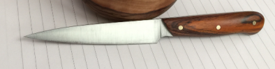

Funny story about this little paring knife...
When I made it I took the TBE down to something like 0.006" or 0.007". I took the above photo, posted it to this thread, and put the thing into the kitchen knife block. Anyway - things have been kind of busy, so it just stayed there. So..... I was kind of surprised when a couple days ago my wife said she had been using it a lot, and really, really liked it.
Ummmmmm ...... I have not even sharpened it yet!!!!!
