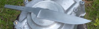

I've just finished a fairly niche knife (and only my fifth or so full tang knife). This is an experiment for an ultralight backpacker. I was trying to see how light I could get a proper knife without compromising the utility or durability of the blade (granted it's clearly focused at light use, not anything too abusive). It started as 0.084" AEB-L stock and I tapered the tang down to 0.010" at the base of the handle. The handle was also lightened by drilling out a large portion of the handle with 0.201" holes. The 3/16" pins are grade 2 titanium and the scales are walnut. (Not positive about the scales, the wood was scrap that had been kicking around for a long while.) The final weight is 41.6 grams (1.47 oz) for a knife with a 3" blade and 7" overall length. I quite like how it handles. The balance point is right at the front pin, uncommonly far forward for a knife of this size. Please feel free to leave any comments or critique!
Great project. I was very much into lightweight backpacking. To save even further weight, you could have shortened the ricasso and brought up the grind to a full hollow. And use carbon fibre pins. 🤓
