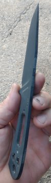

Yes it hold up real well, it's a lot more finicky to get right than FC though...I mixed it up from some stuff my dad had for a million years...
View attachment 1617711Experimenting with manganese phosphate (Parkerizing) solution...View attachment 1617712
Like it !
On mine screen this is 6 foot long knife :)

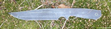

I'm going to cut this one out of 0.94" 1095. Blade is 7 in Long by 4 in high. I've also got this one posted over in the kitchen knife forum hoping for some criticism before I go and cut it out!IMG_20210812_130834380~2.jpg
I'm going to cut this one out of 0.94" 1095. Blade is 7 in Long by 4 in high. I've also got this one posted over in the kitchen knife forum hoping for some criticism before I go and cut it out!View attachment 1618458
I gues it is 0.094"? I like it. I would give it a very slight belly from the middle toward the tip and lose the hole on the blade. You could also give it a slight raise toward the heel. Keep the material on the handle so it balances better (no cut out). Probably won't need or be able to raise the bevel higher than 2" with such a thin stock, so no need for a plunge.
0.94 or 0.094 inch? both seem strange for a cleaver
otherwise i second @FredyCro's advice
