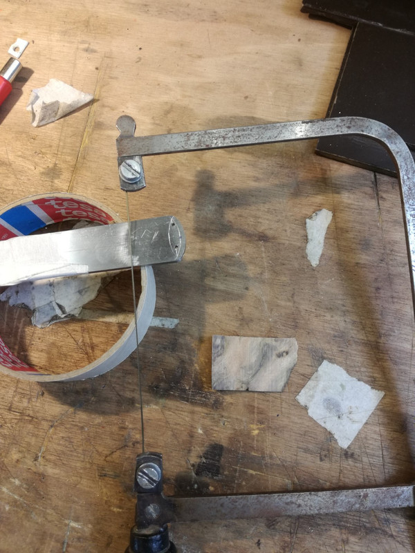

Getting back into it. I almost forgot how much I enjoy working on fine details. A small three finger knife for myself to test how I like a hollow grind as an EDC.
(and test some other things)

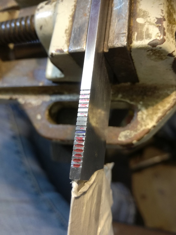

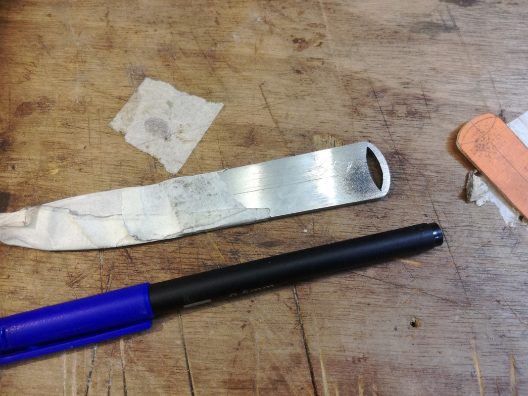

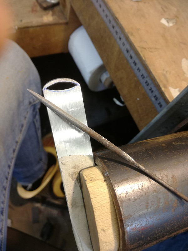

What to do with a checkering file:
And on the end:

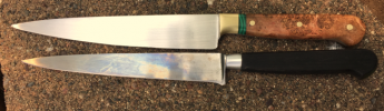

continuing to put in time to clear my "backlog" . this one is is actually a kitchen knife for myself. It is meant as an "update" of one of my 35 year old Sabatier "Nogent" knives (black handle on bottom of photo). They sell it as a 6" "chefs" knife ... but I have always thought of and used it as a Utility knife. The Nogent knives have a much thinner blade than the Sabatier "Elephant" knives and use a hidden tang handle - so this one was/is light and responsive in the hand and cut cleanly. For many years it was the first knife I reached for for small slicing chores. You can tell the edge has receeded through many, many sharpenings....
The "update" is S35VN at 62 RHC, brass bolster with peened brass pins (which just disappear when the thing is sanded down), reconstituted gemstone (yes, I stole the idea from Horsewright) and stabilized cherry burl with peened brass pins. I am looking forward to getting is sharpened and trying it out!

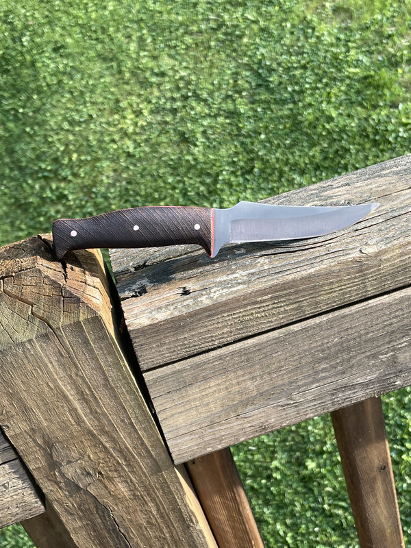

still messin around with my hammer. Lol.
Really digging that simple styled Jelio
