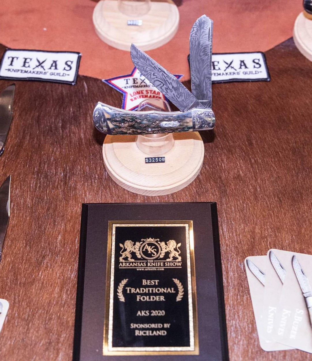

Attended the Arkansas Knife show this past weekend and was honored to win
Best Traditional Knife Award
My Texas Trapper pattern
Bill Poor bold River of Fire Damascus
Mammoth Covers
416 integral liners and bolsters
Alice Carter engraving

That's fine craftmanship right there.
