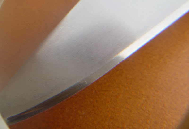

I admit i had never used a carbide sharpener for the concerns about the edge cleanlyness vs a kind of burr; I fear there may be issues in trying to sharpen a keen edge like i'm sharpening a pencil... removing a curl on the edge; i think i may not be able to avoid to gouge the edge itself and ruin it, accounting only to the v angle instead of other important edge attributes that i can obtain with fine abrasion. I figure it like i'm trying to put the finish on the blade not with fine grit papers, but with a "sen" (japanese scraper).
I repeat: i had never used one of those and i see they sell well, so maybe my preconceptions lead me totally wrong and i will become a carbide sharpener addict when i will try one :)
The design is sexy, at first i tought it was an angle gage only for measurement.
Can you please post a loupe view of the obtained edges?
Thank you, and best luck with your project!!!

Stefano,
Many have a preconceived idea of the results when they see this is a "V" style sharpener and this is with good reason. But I assure you, the only commonality is in the name.
The results from this tool even surprised me and I'm the inventor. The reason the results are so different is in the precise construction of the tool. Ever surface aligns with all other surfaces. When an edge is set into the "V" it is cradled and you can feel this. There is also a channel between the carbide surfaces that allows the swarf to exit the area in contact with the carbides. I believe this is one of the major problems in using a "V" style sharpener; there is no place for the residue to escape; the edge ends up running through this puddle of hardened steel that has been removed from the edge. Alignment is another reason they never worked. Bad alignment results in chatter as the edge bounces from side to side. :( I am getting some micro graphs done for an upcoming video but for now I think you can get an approximation of the results from these photos. Thank you for your comments.
[/IMG]
I don't want this great thread to turn into a discussion on my invention; please PM me if you want to talk.

Thank you very much Fred, i appreciated your explanations and the images. :thumbup:

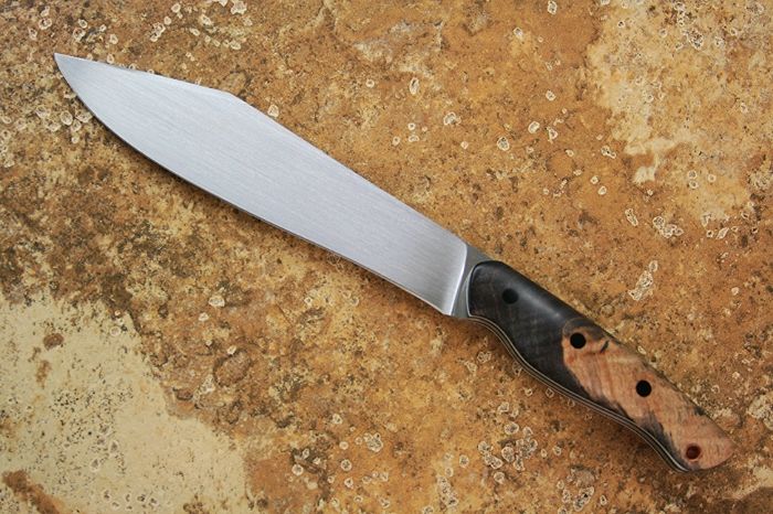

I have really been enjoying this thread.
Here is a little bit of what I have been up to...
Finishing up this one soon...
And picked up my first forge. Ready to start learning, just have to hunt down an anvil...

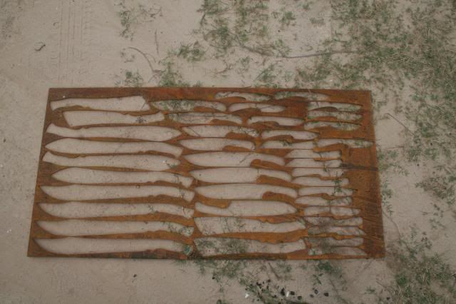

Actually, Rick, I was thinking I should spray paint it flat black, hang it on a wall in an art gallery, give it a title involving war, and sell it for a million bucks. :D
