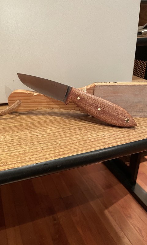

last time I mounted a handle, I got ahead of myself and started contouring before I finished the perimeter of the tang. There was enough of a flat surface left that time to get to good enough, but it really helps to have one continuous plane to slide around on the toolrest in order to make sure all my nooks and crannies are clean and square

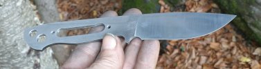

A 9" blade of firsts for me; first time making a knife from a file, first time freehand grinding, and first time heat treating.
Clayed the spine with furnace cement, heated with a torch, quenched in canola oil. The photo is after the second temper in the kitchen. The spine is still soft, the blue edge skates files.
Can't see it here but there is a hamon.
