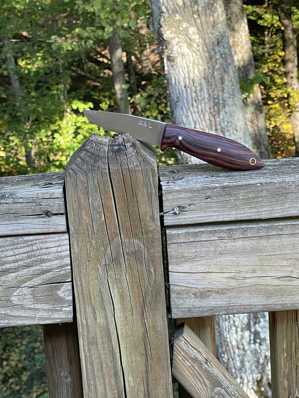

I finished my first slipjoint with bolsters and wood (rosewood) scales. It turned out well.
That's fantastic, Sean! How did you get the shield in there? How did you get the wood to be perfectly flush with the bolster?
Was that from a kit? Did you design it yourself? The shape looks perfect. How is the pull?
