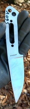

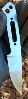

First and last , no more integral knife in my shop .Maybe in my friend shop on CNC ! I finally grind bevels on this one , it s time to finish it .Not easy task for me with this one , but it is almost done now . Full Hollow bevels on my 17 inch wheel :) I really like 52100 . Good steel , easy to grind and hold sharp edge .Remains to mold somehow that carbon around tang :eek:
I remember the press you were working on. Could you maybe make a mould molded by the shape of the tang, maybe some plastic or silicon. Like doing the rough shape of the handle scales in wood and use that for the negative of the mould.
