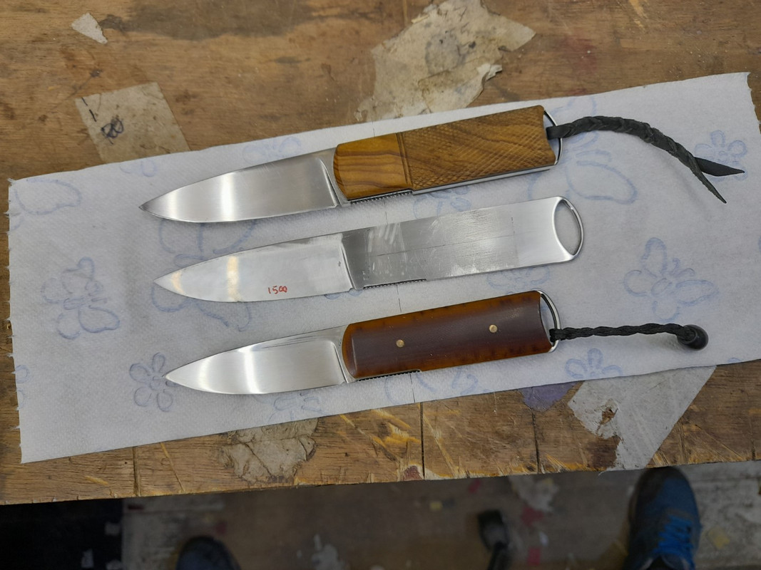

Wellllllllllllllllllllll.... about one year later I finally got to finishing the damn things... not FINAL as I need to touch up the finish the handle metal in FC and shave off some handle on the smaller one and then sharpen them but it's looking like this:
So I see the lighter spots near the handles on the blade.. my guess is that came from the HT as I asked a buddy of mine to do it in a forge. I figure he didn't go past that line for the heating and quench? As for the veins on the blades, does that come from too much soaking in FC or not enough super fine sanding in between dips (like 1500+)? Anyways overall I'm pretty happy with my first attempt non the less! Inputs and tips very welcome :D

Thats amazing for the first attempt. As for the lines, possibly decarb as it looks that you finished the blades almost completly before HT? The silver lines could be where you sanded through the decarb.

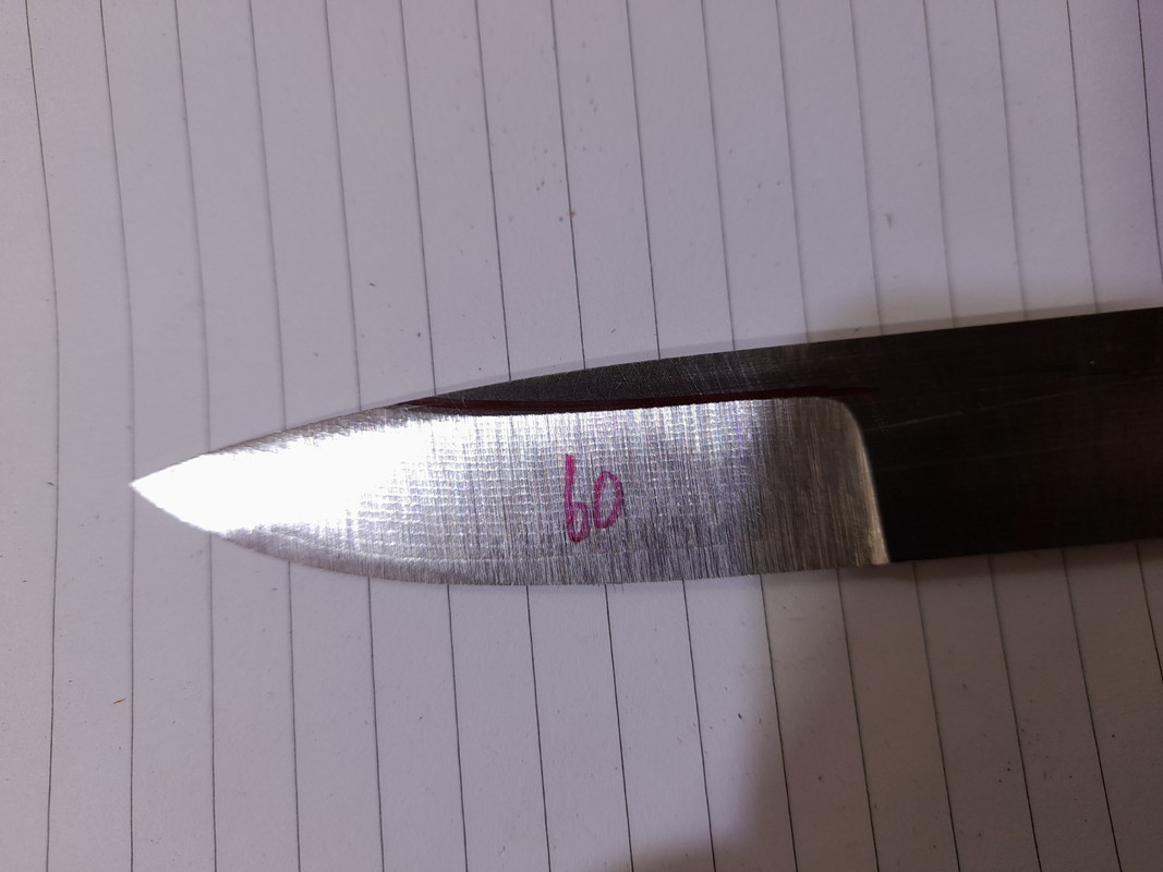

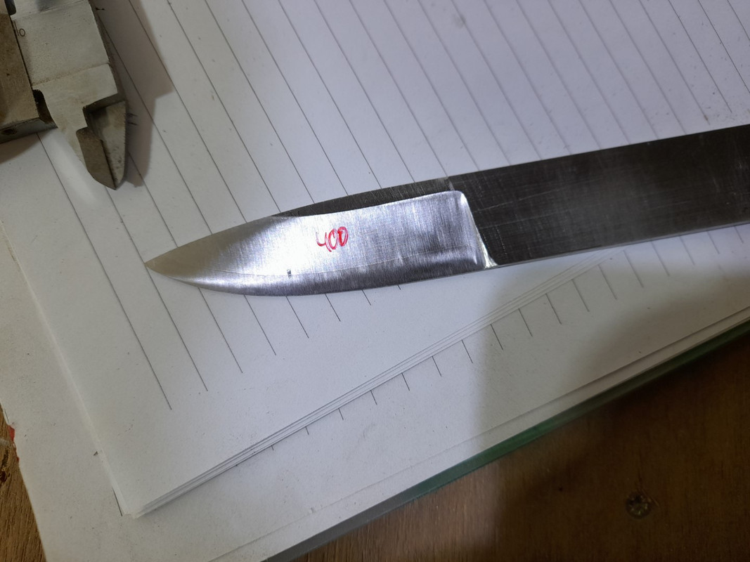

First time working with non-mono steel.
33 layers of stainless with a VG10 core.
The lines actualy help see where you're removing steel on the grinder.
Not cheap but an enjoyable steel to work with.

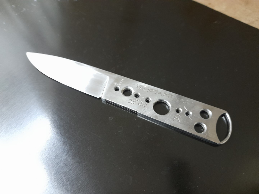

It's going to be a 3-finger knife.
Ready for HT.
Can't wait to get it back and etch!
Cool! I have a bar of that waiting, would be cool to be able to forge it a bit to upset the pattern a bit. Please report here with HT protocol and how the etch went.

I outsource HT but I'll keep you posted on the etching.
I've read around a bit and I'll try sulphuric acid first. I've finished to 1500grit, that may be to fine for a good etch, but that should be a quick fix.
Alternatively I may try a long etch in warm citric acid.
