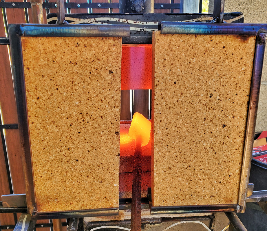

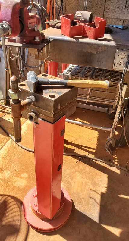

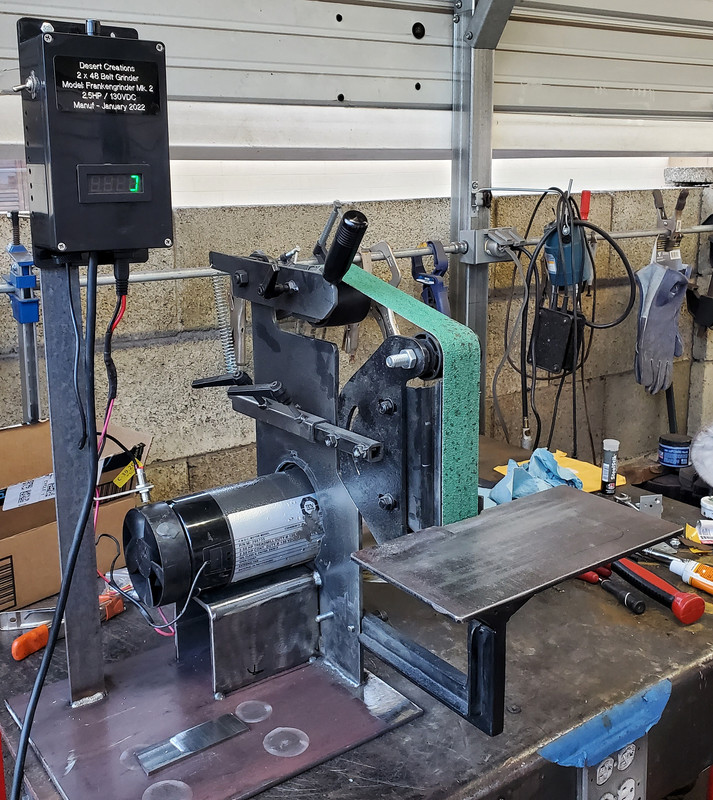

Longtime yard art welder, first time knife maker. Pretty much everything is homebuilt - forge, anvil, work table, belt grinder. I've done a couple RR spike knives but this is my first stem-to-stern attempt at making a blade.

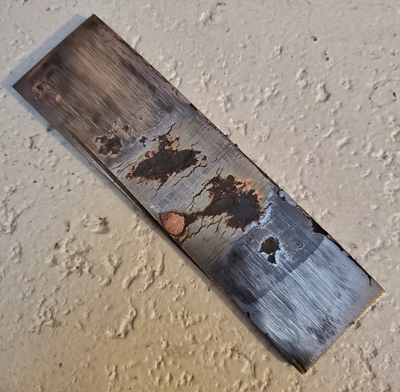

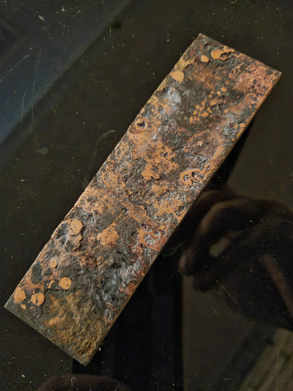

Of course I took the dumbest (difficult) route, a stacked steel and copper billet...
I figure most everything I start out doing - the first few articles are practice anyways so I try all kinds of things to see what works and doesn't. Like: don't try to draw out a billet like this with a hammer - gets pretty messy. Don't heat it up so much to avoid the pitting and screwing up the brazes. Flatten the damn thing better!
I left one side raw and ground the other - man, symmetry is HARD! Lots and lots of mistakes but in the end, I'm not complaining.
