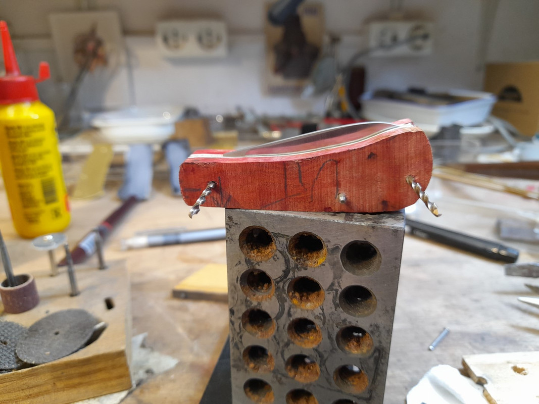

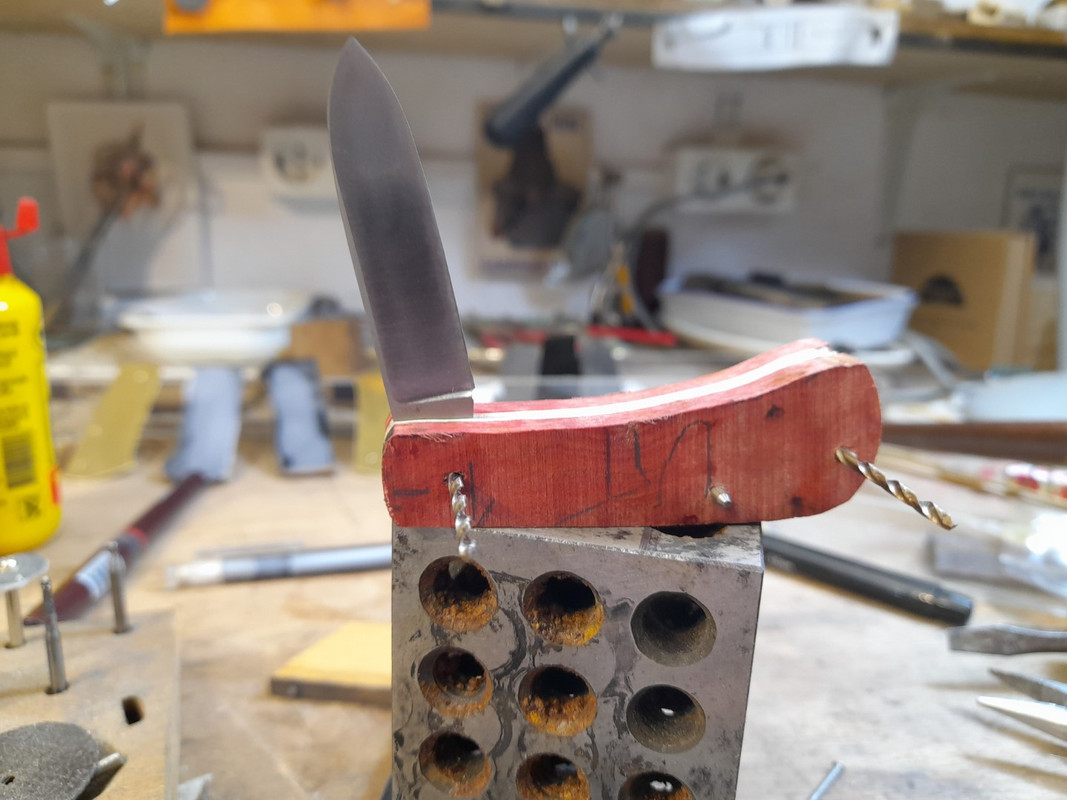

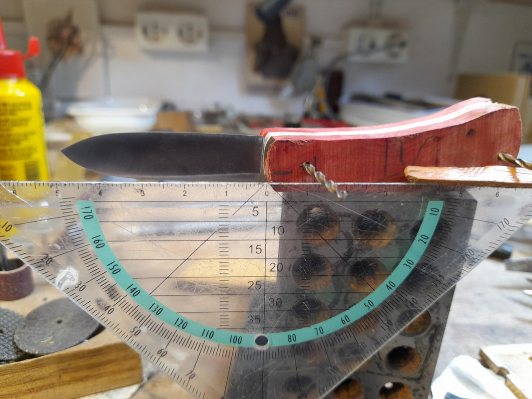

A zulu-spear slipjoint because I like the flowing lines of it closed, and friendly red pink-ivory scales for a non-tactical look. (white g10 liners)
5cm/2" blade
I still have a lot to learn about slip joints but I'm happy with it being nr.6 for me.
