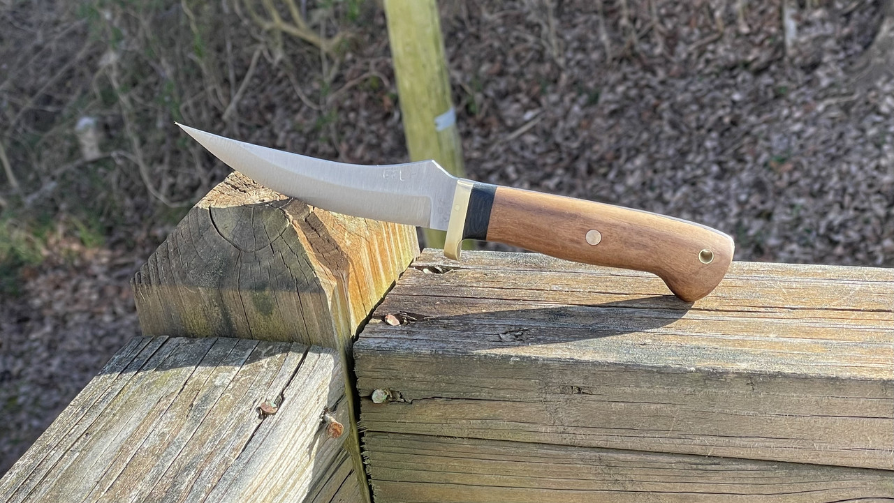

A couple of kitchen knives in the works. The one with the round tip was a request from my wife. Looks strange to me...
Both are AEB-L harden to 62-63 HRC still need the scales finished, some polishing and a final edge put on.
