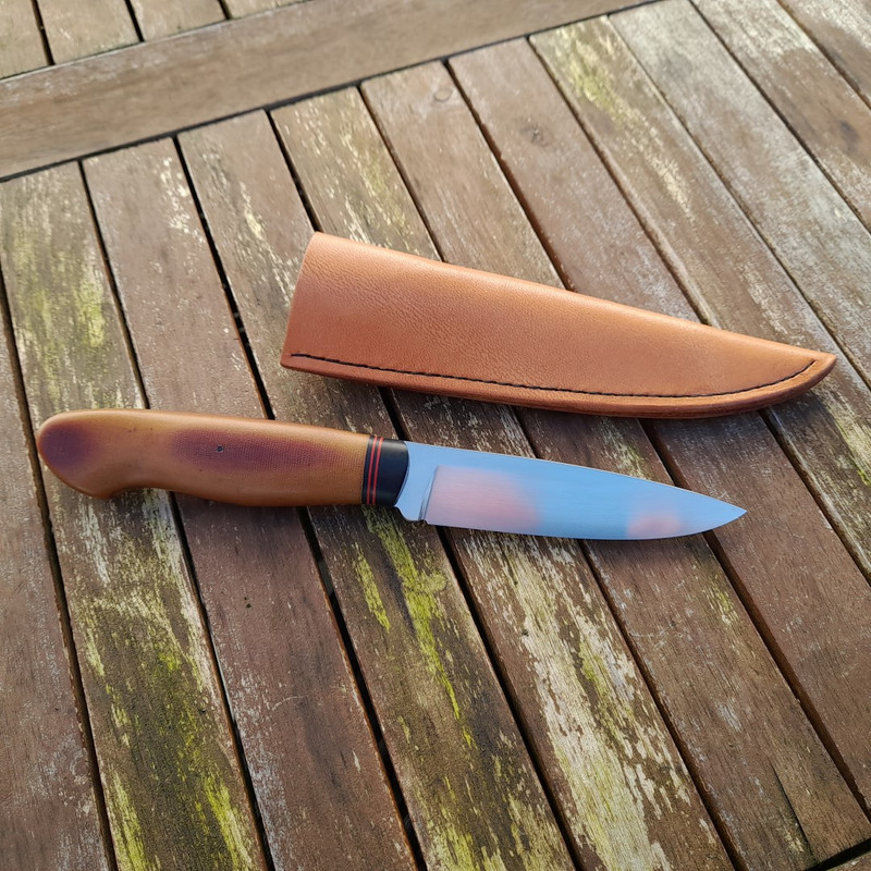

Why just for thin steel ? This two pieces are 4.5mm thick CPM S30V hardened on 62 Hrc .Straight as it can be straight . Now I need to decide which design the knives should be and continue with the work. There are even advantages to this method. There is no fear of cracking, warping of steel , hardness after HT protocol ......All I need to know is there before I start to work on steel . It's not very pleasant when after so much effort to finish the knife, something happens during hardening and the knife ends up in the trash...............I am right ?

I'm guessing you use a carbine bit for the pin holes?
Yes , drill bits for ceramic and glass drill hole in hardened steel /no matter how hard and which steel / like in wood .To bad that I can t find them under 4mm size . For smaller hole I steal / OK , I borrow , but I never return since they break easily / some real carbide drill bits from my friend shop ;)
PS . When they break some of them around the tip, they throw them away. I can sharpen them again..so :)
I get this one some day ago . I sharpen some of them for scribe lines on steel .
Doesnt grinding thicker profiles from hardened steel kill your belts or take long if you use old belts and need to cool in between?
Come on Fredy , it takes five minute to cut and shape knife , crank that belt speed on maximum ! This is 64 HRC 5 mm M2 HSS steel ,easy work for me .It s me or my Klingspor belts are something special i don t know for now .
As long as it works for you! Makes sense if you are using hardened steel. I have some 2.5mm m2 straight saw blades i want to try for kitchen knives. When i start with bars i lay the blanks for saving material, like tang to tang.
If that works for me should work for everyone . Much easier, much faster and 100% safe way to make knife . What is the difference between using an ordinary HSS drill to drill hole in soft steel and to drill hole in hardened steel with carbide drill bit ?
Never mind , as you say ........................as long as it work for me ;)
