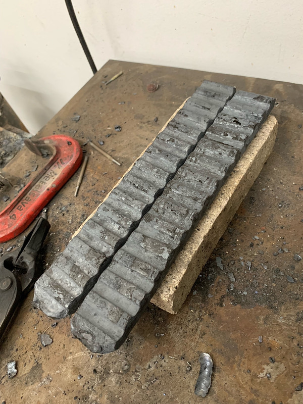

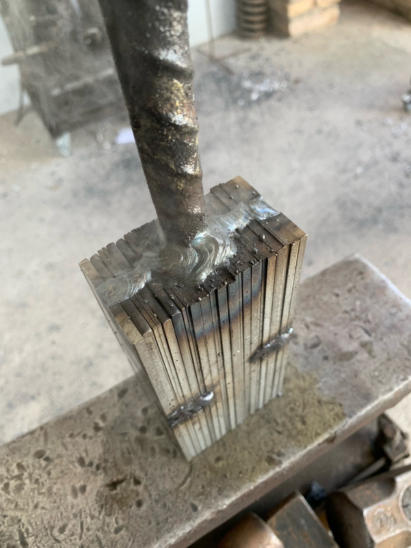

Just forging some damascus, and nope, it wont be a ladder damascus, tomorow ill forge this bars again!
