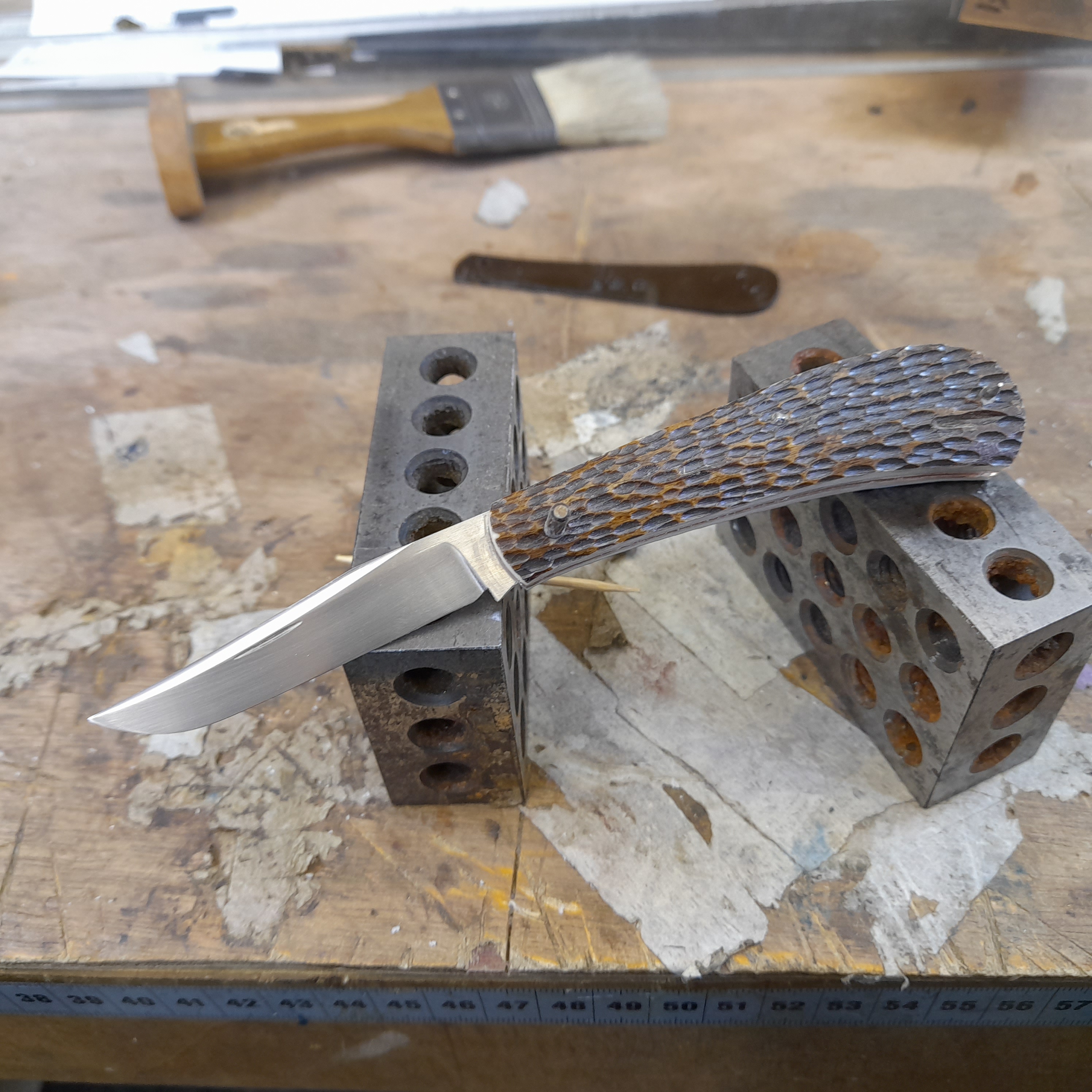

Slipjoint #8 in the works. After final contouring the scales will be a nice two tone, white-brown finish :)
RWL34 with bronce liners.

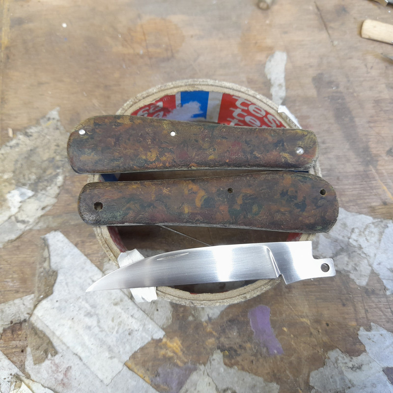

This is slipjoint #7, my first warncliffe.

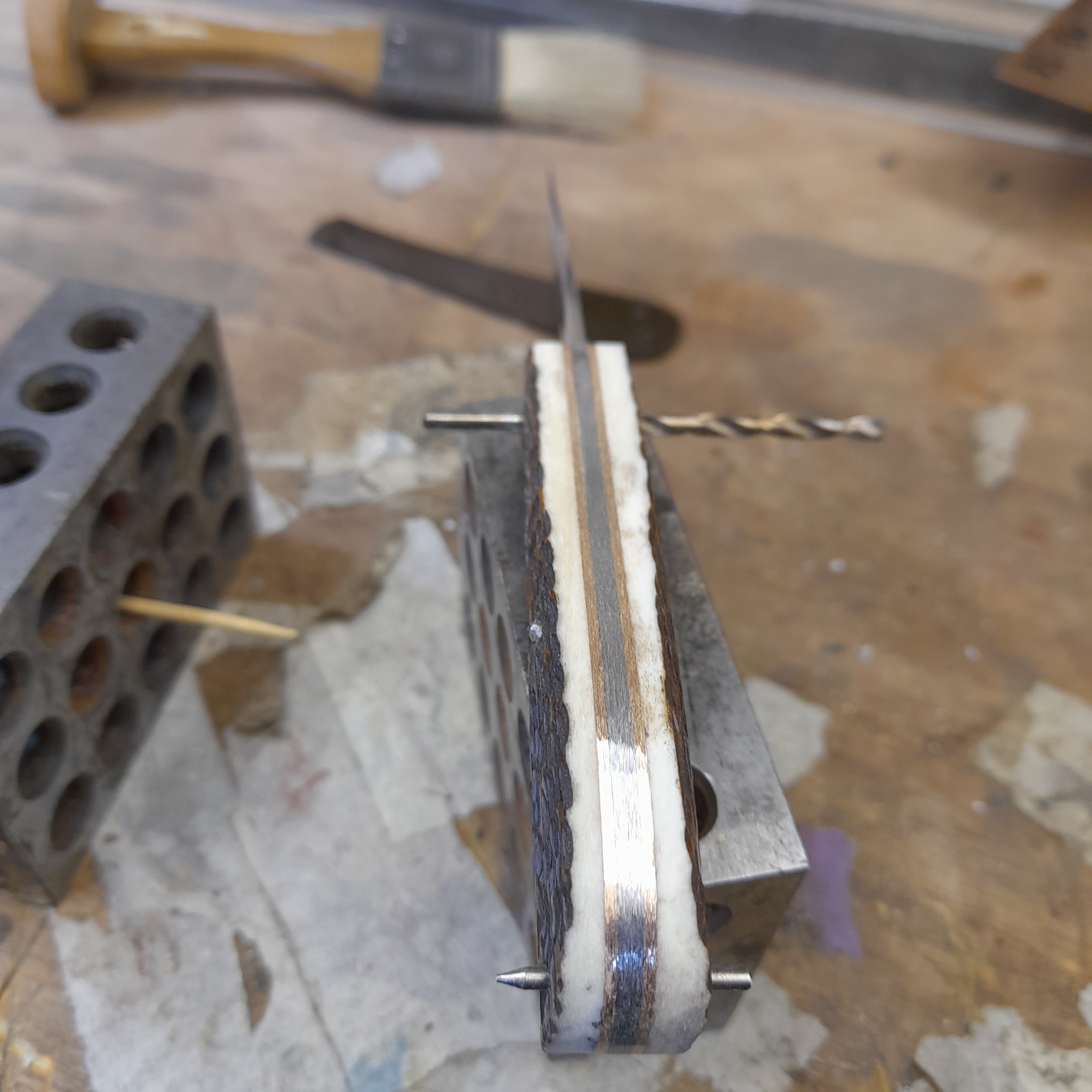

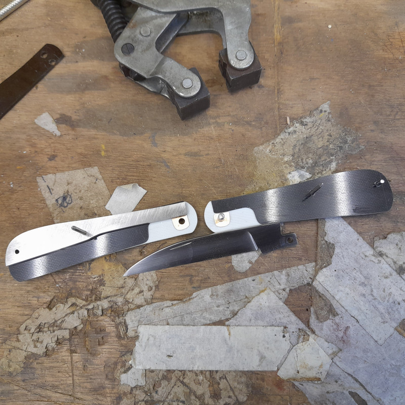

Not having a mill tickles the fantasy. I build the liner up out of two layers of 0,5mm G10 and sawed oud a recess for the ricasso to move freely.
Around the pivot is a 0,5mm piece of bronce.
I really like the two tone look the liner has this way.
First time using rag micarta, this is east German, former DDR stuff!
edited it is #7, not #8
