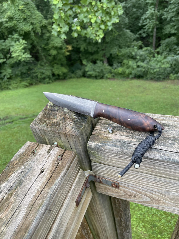

FInished up this classic style gokujo/boning knife for the Kith. Thin stick tapered for a nice amount of tip flex
Simple knife but very happy with the result and small details. Good old 1084 with swamp Kauri handle heirloom fit.

The knife looks good, but just out of curiosity, why did you heat the tang up?

Oh I was going to ask this in the post above, but I forgot N Nick-D I've heard the term heritage fit before. What exactly does that mean? Ive never heard an explanation of what it means Is it just a style?
Yeah it refers to a non flush fitup. You can see the scale on the handle in the second photo are about a mm proud of the tang. It's sometimes referred to as a museum fit as well.
Used a lot in hidden tang fitups between timber and bolster material.
Adds a little visual interest and prevents sharp edges forming between 2 different materials that will expand extract at different rates over time.
