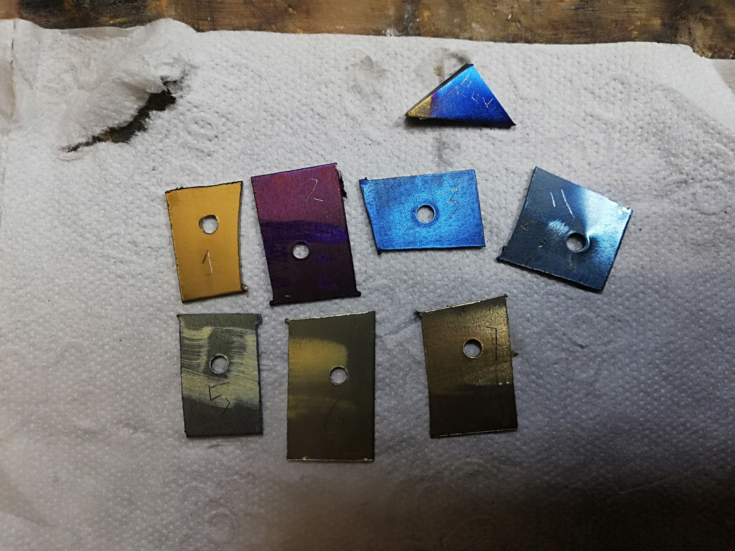

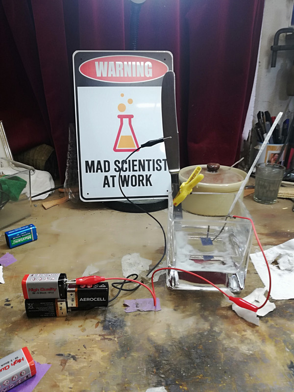

Trying something just because I always wanted to try it. Just having fun.
No decent finish or prepwork, just cutoff pieces and seeing if it works.
I went 1 to 7 9V batteries because I had 7 batteries laying around.
I'm using water with baking soda disolved in it.
The rectangular pieces are normal Ti and the triangular piece is 6Al4V
I did it in a cold workshop I think the batteries will give a different result when it is warmer.
(like how a car battery works poorly when it is cold)
