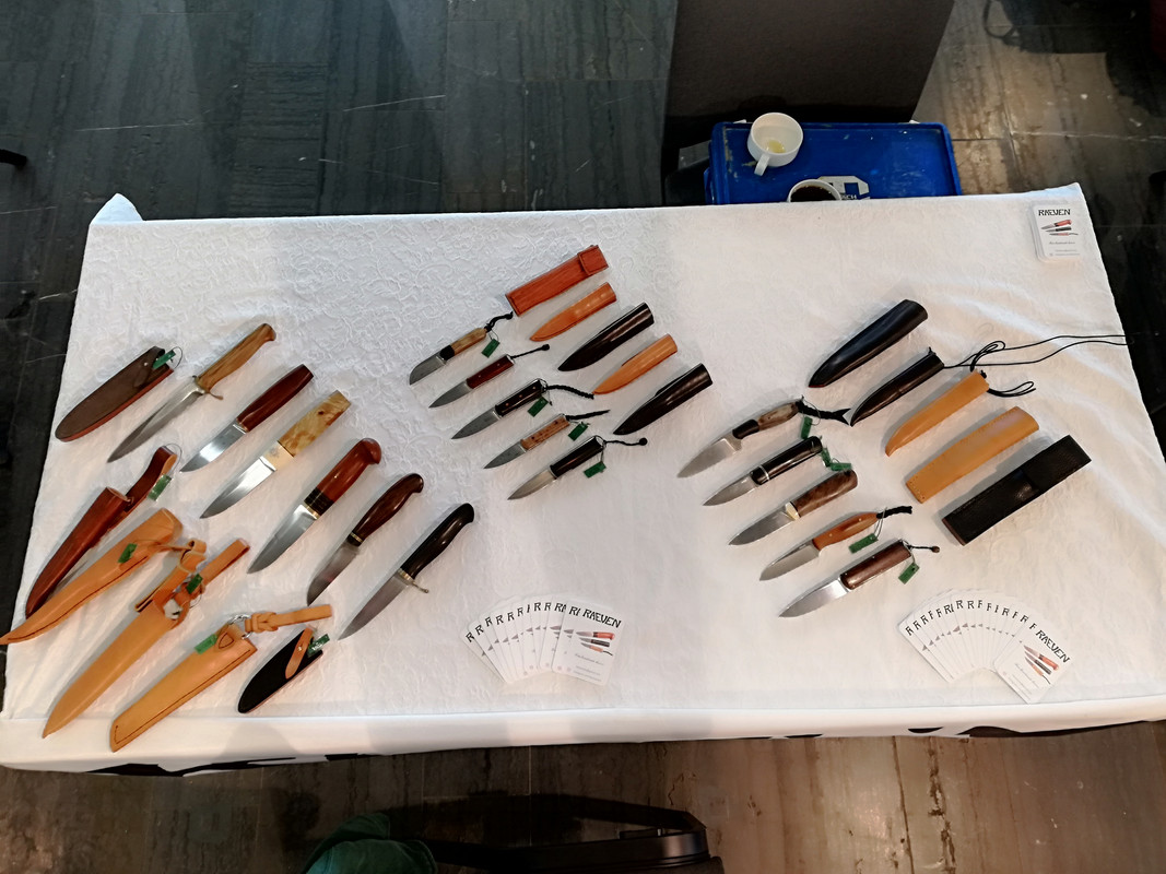

I actualy got out of the workshop and I realy enjoyed it. My first time having a table at a knife show.
I spoke to a lot of interesting and interested people and made a few people happy with my work as well.
Very cool, I've never even been to a knife show.
