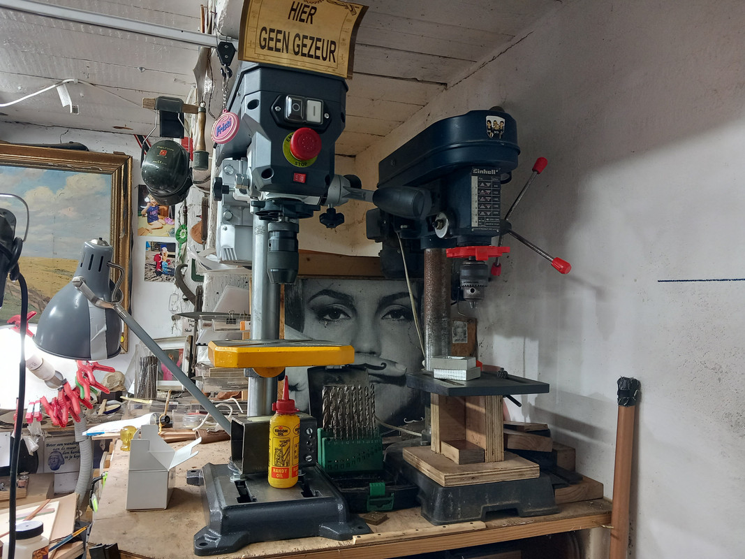

Got myself a new drillpress. My old one is a cheap machine that I used and abused over the years and now has way to much run out to make slipjoints.
The new one is a lot more solid. It's not much bigger, the motor isn't more powerfull but it is build for precision.
The new one is for clean drilling only and I'm keeping the old one for if I want to do something a drill press doesn't like.

Enjoy, thats a beauty, as bad as mine jammed up to the roof. :)

Do you know what the equivalent make/model would be in the US?
