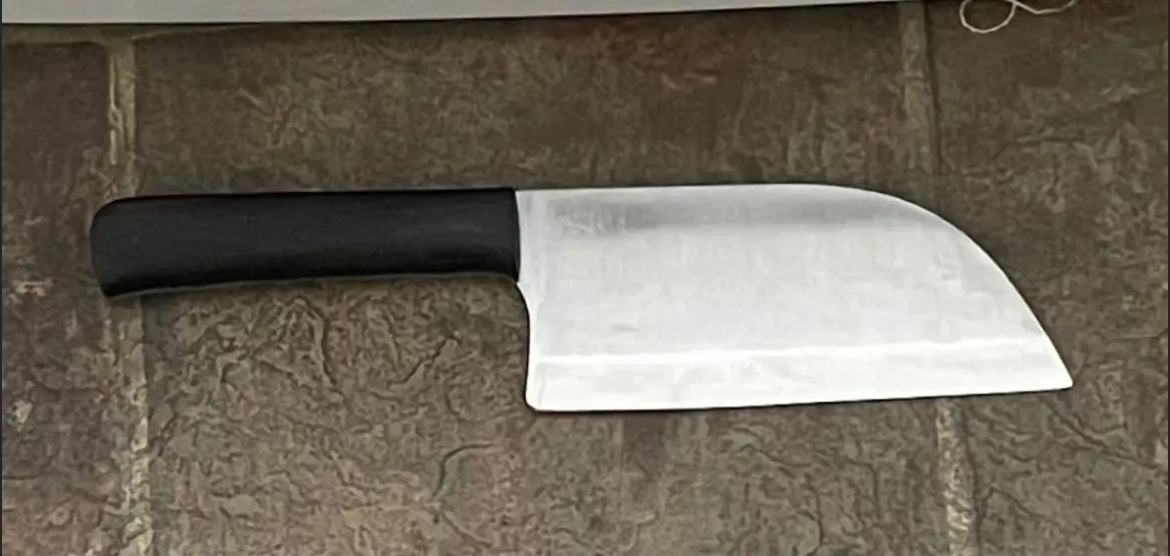

what are the holes near the spine for?
Just an accent for some brass dots.
No functional purpose
