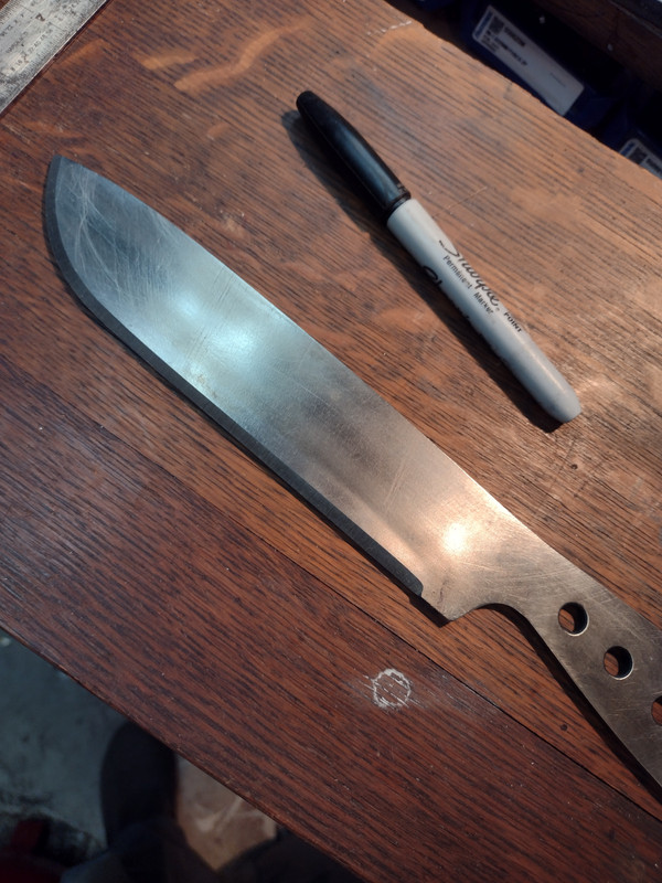

Just heat treated this blade of CPM154, this has to be one of the nicer heat colored blades I've seen. I wish there was a way to preserve this finish, but....alas, it's gone now and on it's way to finishing.
David Mary David Mary
Just less than 10 mins to crudely rough out rough edge. I just started doing This. Previously I just ground to my primary angle that I wanted....
I still don't know which is better. I haven't had anyone explain it to me that makes sense?
-so I'm trying it.
Used a very used ceramic belt, was maybe 60g. Should be thrown out.
After coffee break, I'm going to rough my primary.
That will take longer....but I'm a Slow maker.
Just over 7" blade, 60HRC
Now you always know where the center is.
But I Still have to do it the first time....

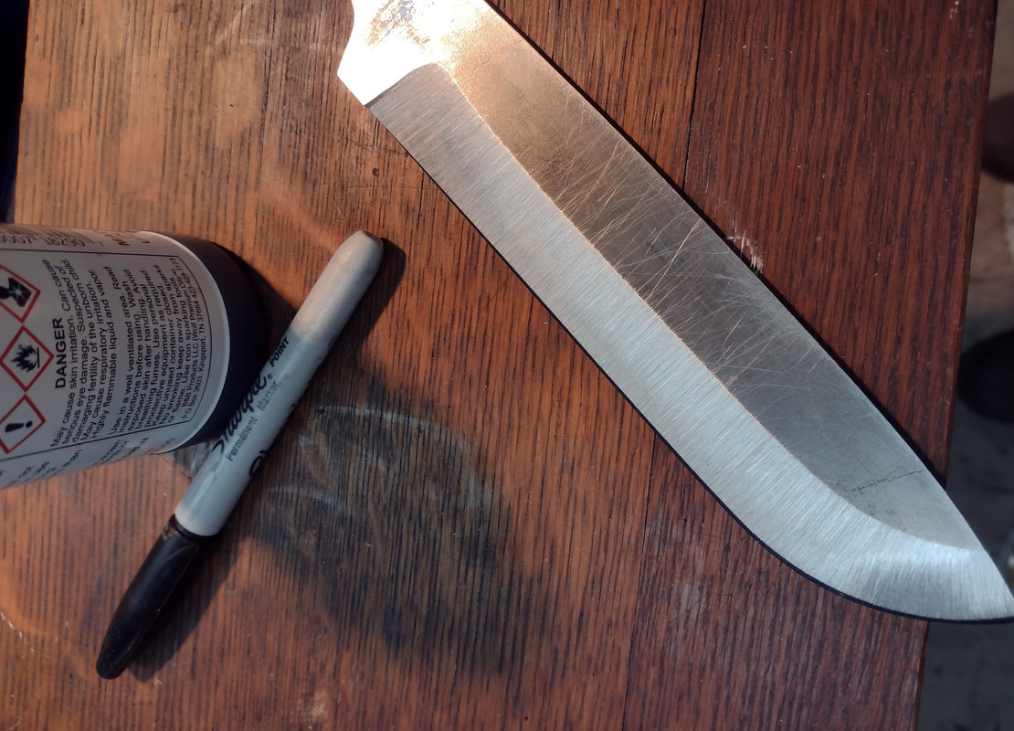

Here is 27 mins more, (Both sides of blade)
Including a belt change for a new 36g.
I'll now establish bevel, bring up shoulder, thin tip some, and start blending a convex.
It will be slower, and idk if I will post that time
Crag the Brewer Crag the Brewer is this going to be a full height grind?
Not really.... Higher than it currently is, but I'll round the shoulders to a convex.
Flat vex kinda like Yours, maybe a little more arched?
I usually go somewhere between flat and convex. I'll raise the grind some, and then blend it all in

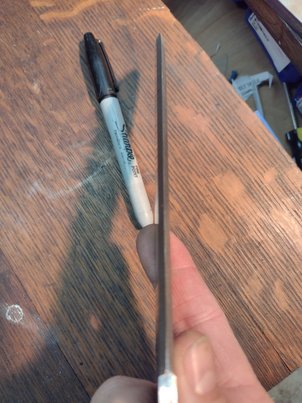

regarding scribing a centerline. When I first started showing my work to some pros for criticism, I had one gentleman take his fingers and sort of pull the edge through his two pinched fingers. Without looking at the grind he told me my blade was wavy and the edge veered left as it got towards the tip. I looked at it under strong light and he was absolutely right! After that I started scribing a centerline using a pair of calipers. I mark the edge and the spine to the tip. Since then, I have had no issues keeping the edge grinds even.
Prior to this I did exactly as you described. Flat grind to the height I wanted...
Haha.... I Thought you were going to say that Now, you only slide your fingers down. Like the one guy did? That's pretty much what I do. 😬

The first few knives I made had edges that wandered around like crazy. Then I got a height gage and that really helped, both with my edges and my grinds in general.
