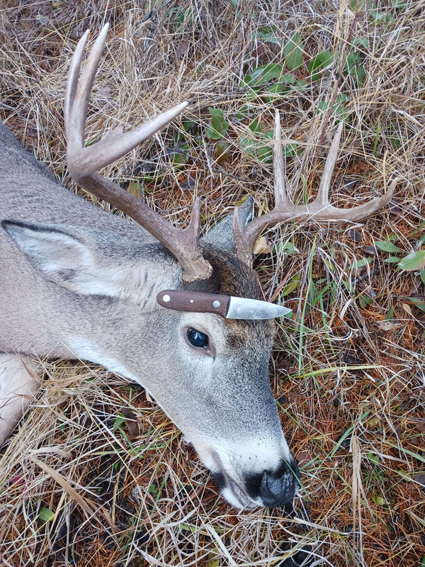

I know many makers have their idea of a perfect hunting/skinning knife but from my 34 years of hunting experience I have always been a fan of smaller more nimble knives for the task.
This knife is non optimized Magnacut at 62 Rc. Spine thickness is 0.070 inches and blade length is 2.75 inches.
I gutted, skinned, cut foreleg knuckles, and separated out major muscle groups with this little knife and it was still cleanly slicing recipt paper after.
I do love Magnacut!
