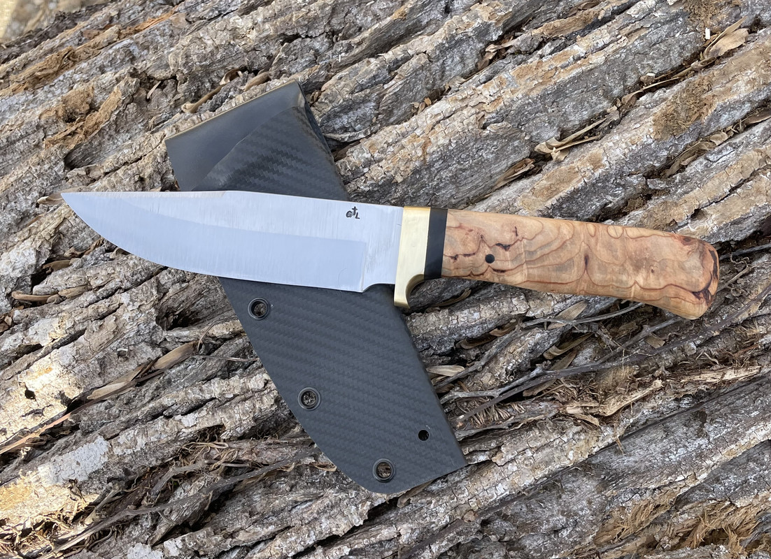

Cut open a piece of rather plain looking Bocote in search of knife scales but found this monster inside instead! :)
