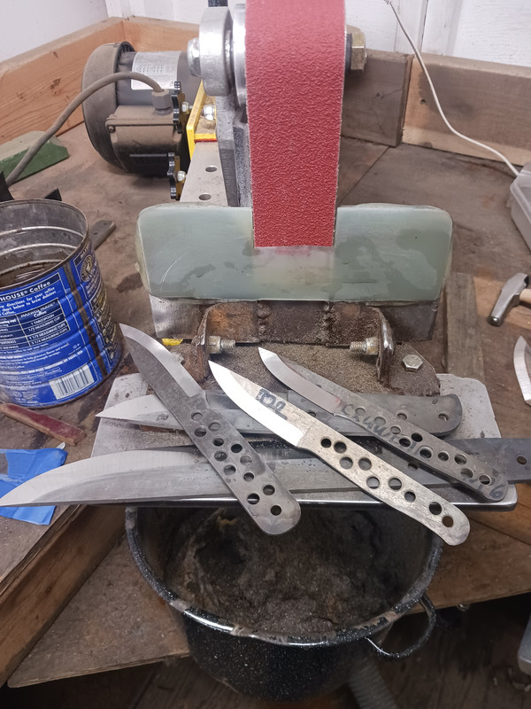

Progress...tangs all tapered bevels all ground in...almost ready for heat treat.
I free hand on a carbide platen. Never had any issues with warping on these steels (S90V, 4V, 10V...). If I use AEBL I grind post-HT. I send all my blades to Peters' and they have not come back warped yet. I do make a post HT pass on the flat platen after HT to clean them up and ensure true flatness.

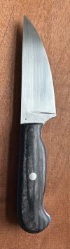

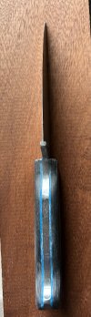

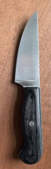

Finished up another. Probably call this one “Bodyguard”. It has that back-up, tactical look/feel.
5/32” 14C28N stock : Paul Bos HT ~63Rc
4” edge : 8” OAL
Charcoal Dymalux w/blue g10 liner
Paper micarta pins and SS Loveless bolt glued w/ white Gorilla glue
Blade and handle at 400grit “wet” finish
