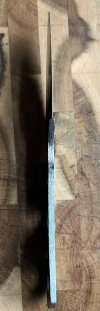

Applying some 3d slice laser effects to threaded bolsters on slipjoint. The end result is a triangular profile of when viewed from the side. placing two of them that are mirror images of the profile close together leads to a thin strip of bright steel after final profiling.
