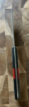

A little craft knife/box opener Christmas gift for my 25 yr old. I tried my hand at dovetailing the inset color. Must have been an ever so slight rotation of one scale when gluing handle to cause a bit of misalignment after final shaping. But I’m pretty happy how it turned out. 14C28N @ ~63 RC, black and red micarta epoxied/pinned in place. 2.75” blade/ 7” OAL.
