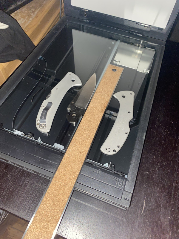

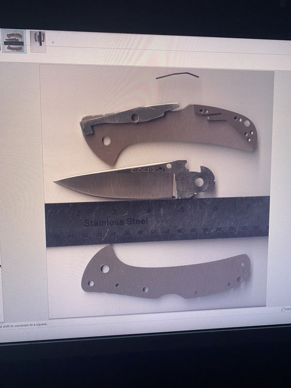

I'm reverse engineering a Code 4. Why the Code 4?
A few reasons.
It is a lockback, and thus seems to me the simplest foling knife mechanism to work with.
I can make a tri-ad lock analogue by using a hexagonal stop pin, thus circumventing the patent issues (ie "cylindrical stop pin"), while arguably creating something even stronger than the standard tri-ad lock.
The Code 4 is the only lock back I have in my possession.
After creating those CAD files, I can mod them into any shape I want, while keeping functional the lock geometry intact.
Another maker on another forum told me that back locks are surprisingly complex. Linerlocks might be a bit easier, but then I’m no rocket knife surgeon.
