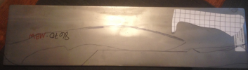

I have to get the grinder back in shape to work on it. So I have been on that tonight, but first, here's the table of stuff next up as it was before I started on the ulu. Ignore the Bowie, it's backburner still, but all the other blanks you can make out plus cutting the sheet tomorrow.
