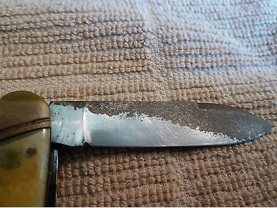

The material concerned that does this is Celluloid Chisumr, and its extremely Flammable and so it can also be unstable in storage with "gassing off" the chemicals that are contained in the Celluloid - 99.9% of the time having devastating effect on the knife-and any surrounding knife stored with it - they rust incredibly badly, as you can see on a new knife owned by Sarah, with luck the knife was able to be retrieved before the gassing off got to its maximum in damage, look back and remember when you have seen an older Celluloid knife with very badly shrunken scales -and the knife is a basket case - you can guarantee that knife has gassed off.
If I am not totally correct on this I stand to be corrected :thumbup:
