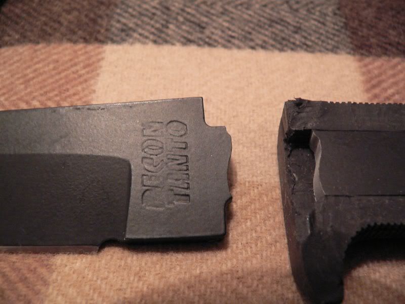

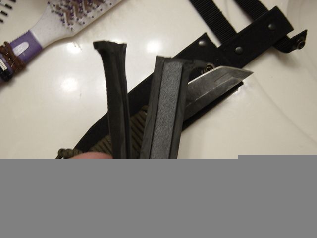

Their middle tier knives in the $80-$190 price range use either AUS steel or SK5/CarbonV carbon steels. These knives come in all sizes like Recon Tanto, SRK, Recon Scout, Trailmaster, etc. My beef with this line is that even though the price is right, the steel is not. I have literally broken every single CS from this tier I have ever owned. Including TM, Recon Scout, Recon Tanto, SRK. All of them broke doing woodcraft. If this line had the toughness to go along with the looks, it would be great. The kraton handles also leave a lot to be desired. Since they really don't have a good warranty, I have eaten the cost on every single one that failed. Not cool.

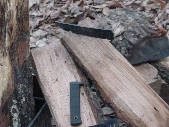

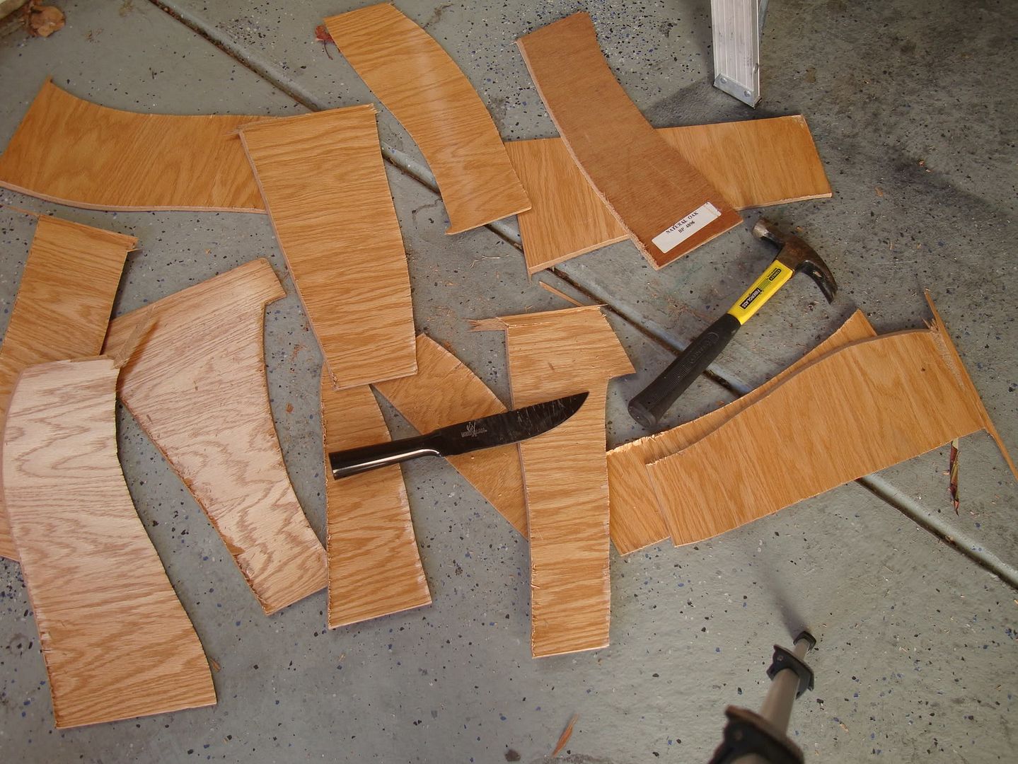

Here are some failures all from the middle tier:

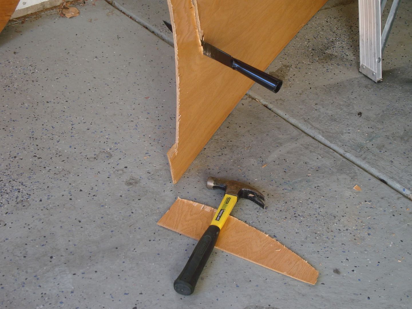

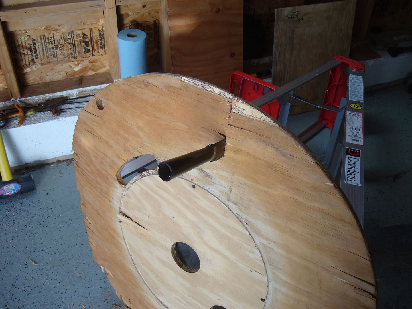

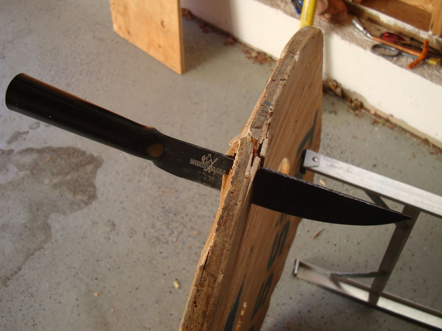

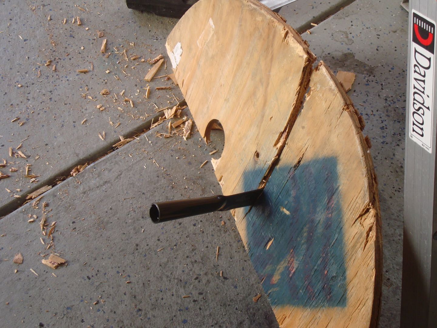

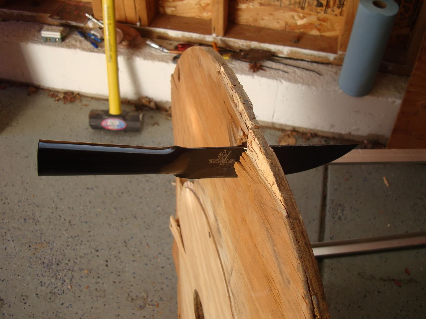

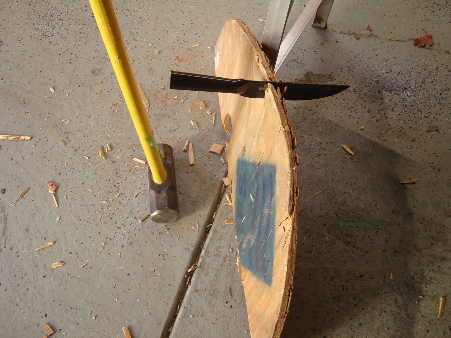

And here is an example of how tough the lower tier level is. I batoned this bushman with a hammer and then when I batoned into the 3/4 inch heavy duty plywood, I had to use a 10 lb sledge to hammer it through(sledge in background). Not damage at all and the edge was perfectly fine:
What more could you ask for in a knife that costs $20
