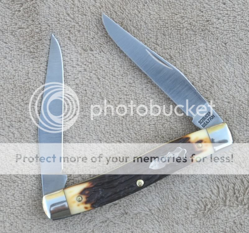

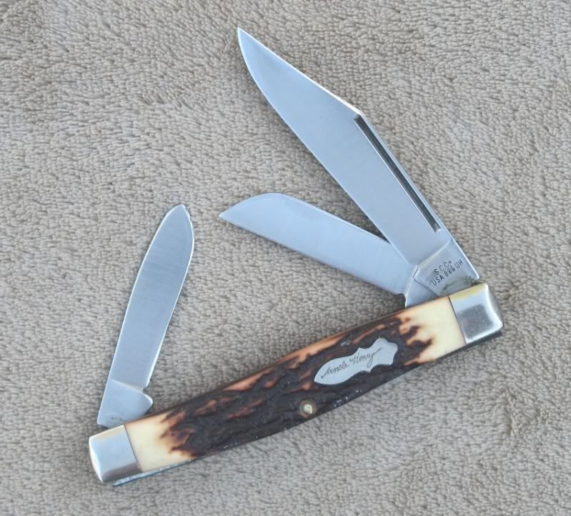

Here are a couple of Staglon Uncle Henry Schrades of which origin has been questioned a few times in the forum:
77UH - Gnarly Staglon!
886UH - With the mysterious S.C.C.+ stamp
Nice looking deuce thawk, I've seen those 77UH's floating around recently, not snagged one yet.

thawk--nice ones, that 886 is cool?:confused:

Hal,
Please look closely at the bolsters of that 886 and see if you can find any evidence of a pivot pin going through the bolsters. Tom Williams said that at Camillus they used a S.C.C. tang stamp on some 204S (electrician knives) that they made for Schrade. I am not sure if Camillus used the S.C.C. stamps on other patterns, but I think it is likely.
If the 886 is through-pin construction, they we know that it is quite possible that Camillus made them, as Camillus never tooled up to produce the Swinden Key type knives.
Your 77UH is nice.
Ya' gotta' love that Gnarly Staglon! :D:D
I bought the first one I ever saw on ebay for $135. Never saw another one with the UH shield and no Ducks Unltd. etch or shield, until Larry said he had one also. Now from looking at ebay, it looks like someone was setting on a pile of them. Another possibility someone mentioned, is that they came from the Camillus auction. :confused:
Ah yes, the mysteries of Schrade!
Dale
Dale:
On the 886UH with a magnifying glass I can faintly see the round outline on the surface of the bolsters. On some used knifes this is clearly apparent. These are barely visible. Is this what you were looking for? I looked carefully on my 898UH with the same stamp and single center scale pin, and could not see any evidence.
I guess I've not been paying as close attention to Ebay lately. I had not seen any of the 77UH with the shield. At least I got this one for $65.00. So much for me being a wheeler-dealer, huh? :D.
I know the seller, and asked him where he got a couple of them, and if he has more.

That is it Hal.
That tell tale circle of the pivot pin on the bolsters, means the knife is not Swinden construction.
Now this does not mean that Camillus made the knife, but it certainly makes it more likely.
If a knife is Swinden construction, it was made at the Schrade factory. No other knife maker went to the considerable expense to install the Swinden equipment.
If the knife is NOT Swinden construction, it could have been made anywhere, BUT most of the slipjoints Schrade made, were Swinden construction. No point in installing all that machinery just make a knife without using your investment.
The presents of the pin indicates to me that most likely the knife was not made in the Schrade factory. When they did not make a knife in house at Schrade, Camillus usually made it.
Based on those things & the fact that I know from Tom that Camillus used the SCC tang stamp on some knives they made for Schrade, I think it is most likely that the knife was made by Camillus.
That is my theory currently, subject to change if I find out something different.
Dale

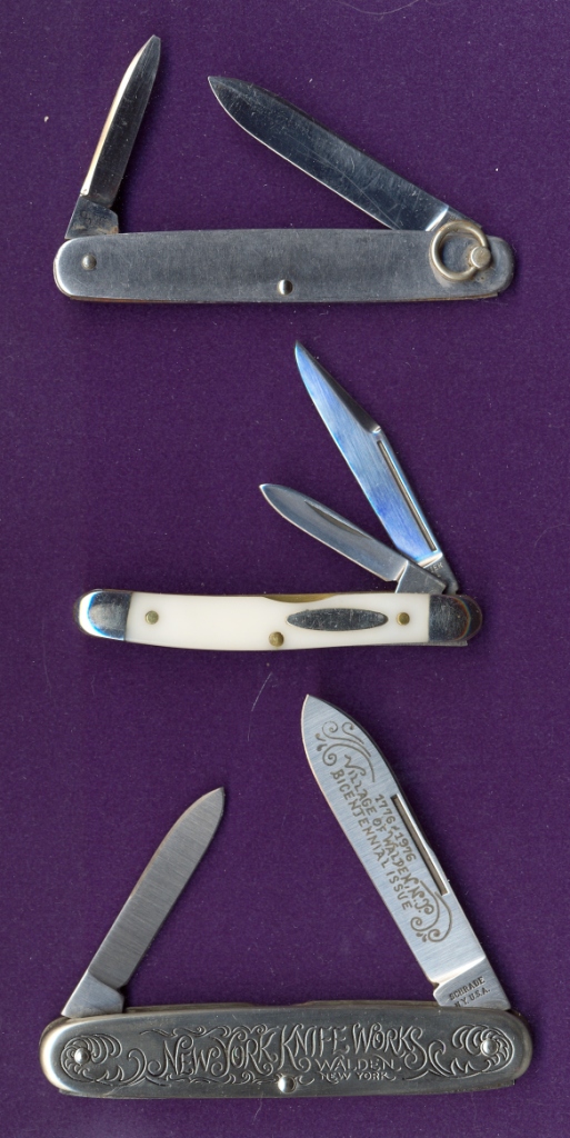

Been awhile since I posted new stuff of mine.
Just acquired these 3 beauties.
Top is a Schrade Walden Stainless. 2nd is a Ulster 81P and the 3rd a Schrade comm. to New York Knife Works from 1976
TTYL
Larry
George, nice grab on the 804, those blades aren't down much at all! :thumbup::thumbup:
Larry, great finds, those ring turns are cool, aren't they?
Eric
Nice looking trio Larry! The New York Knife Commemorative was one of the first Schrade knives in my collection.
Russell
