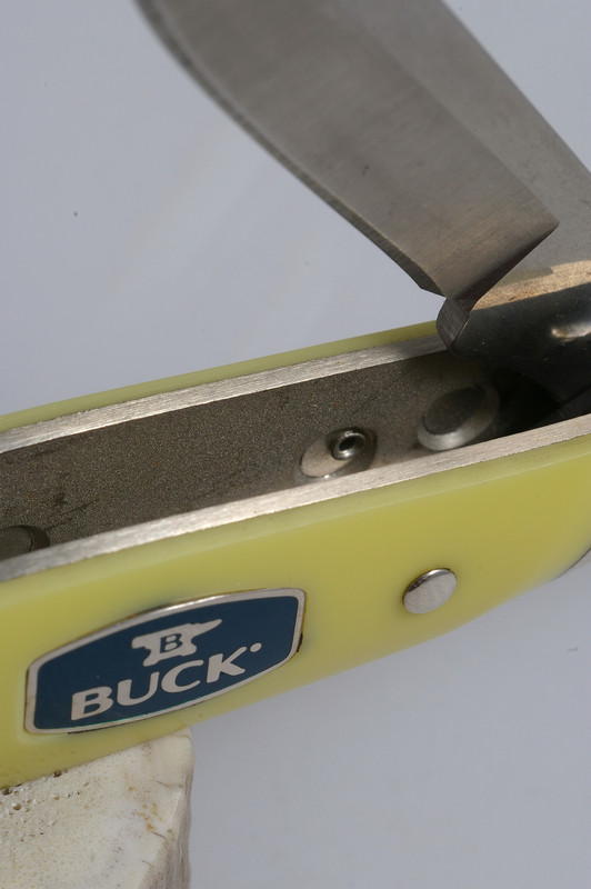

I wonder if the new design which has the tangs of the clip blade and the sheepsfoot blade in direct contact with no spacer is causing some unanticipated problems?
Bert
When I got mine it would close to that point, and then with a little nudge it would "click" and drop down below the sheepsfoot nick. The problem then was that the spey couldn't be opened without opening the sheepsfoot first.Here is my new Red 301 showing the same issue. While the Spey closes a little more than the Blue one, you still see how the Spey partial blocks the nail Notch on the Sheepsfoot blade because it gets "hung up" on something.View attachment 2964876
Just checked and the pins are recessed.I don't have a new 301 to compare to, but back in the early 2010's when Buck had the Comfort Craft series, the yellow Delrin and others had recesses on the inside of the frame to accommodate the scale pins. Can someone verify that their new one has those recesses? Could this area be the source of the spey blades hanging up?
Thank you for checking Mike. After re-reading the entire thread, it appears the problem is good old fashion blade rub. With Buck's design without spacers, the tolerances must be extremely tight. And, the fact that the spey and sheepsfoot are so chuncky on the tip (see post #79), the lack of distal taper makes it highly like that they will touch especially if there is even a hint of misalignment of the one or both blades. I suspect that if Buck were to assemble the knife pivot pins and center pin tighter, to eliminate gapping on the back, it would make the blade rub problem even worse.Just checked and the pins are recessed.
