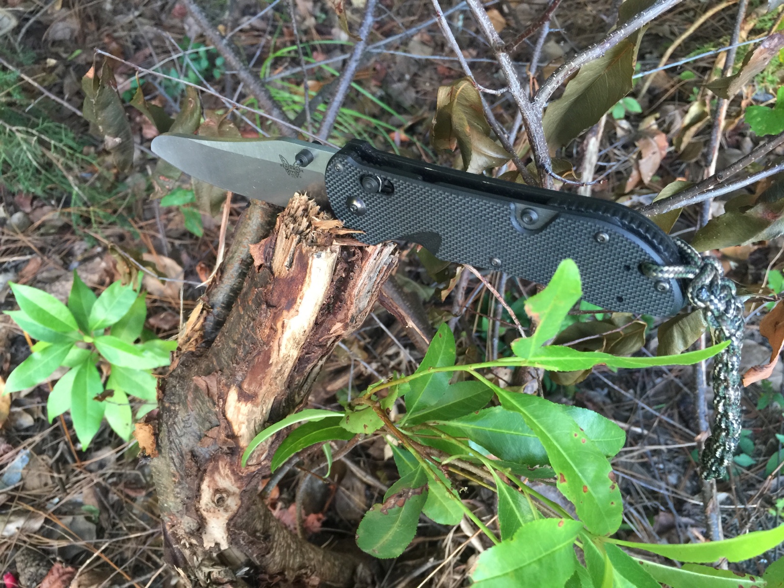

I am currently using CPM-154, I am not going to tell you how much I have beat it up, but I havd only needed to strop it twice in the past 3 weeks that I have been using this current knife. (I have used CPM-154 more than any other steel)
I just used it to pull a ton of very tough staples today, so the tip will now need a little work on the stones....!!
