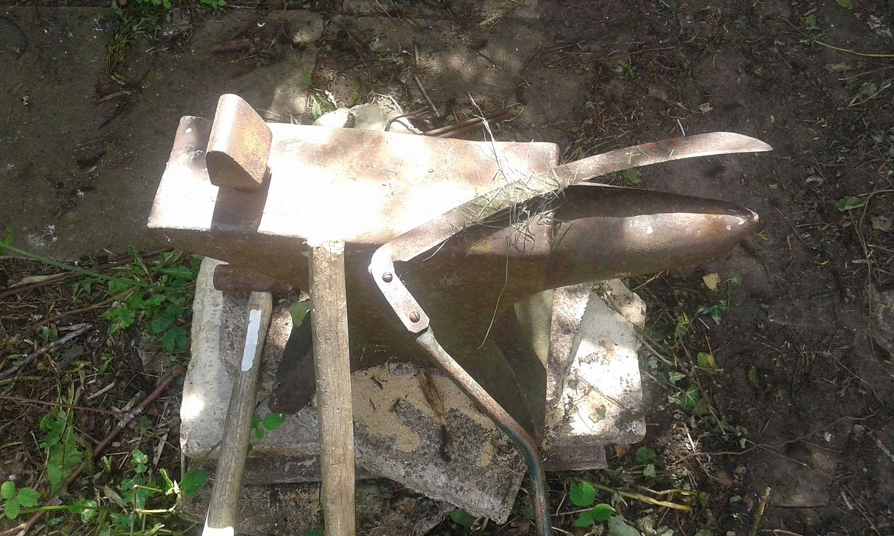

My daughter found an old scythe and 3 large buck saws while hiking in the woods. I was wondering what anyone can tell me about this scythe and whether or not i can bring it back to service.
I have actually filed an edge onto it and I'm waiting for a couple of scythe stones to finish the edge. I also cobbled together a snath out of an oak branch. I've tried it and it works, but I don't think it is sharp enough and of course with this rather unusual set up I can't really know how close it is in form to a proper scythe. I'm sure it's heavier!
One thing that feels wrong when using it is the angle of the blade relative to the direction of travel. At the beginning of the swing it looks to be a little less than right angles with the direction of travel, but by the end of the stroke the angle changes to probably 45 degrees to the direction of travel. I haven't foujnd a good video that shows what the stroke should look like.

When following the arc of the stroke, the heel should remain the most proximal and the toe the most distal or else the blade is too closed relative to the stroke and you're just ramming the spine at the toe into things. Likewise the heel should be engaged in the grass when taking a stroke of the greatest possible depth without bogging down, or else the blade is set too open for the stroke. If your edge is sharp enough you should be able to cut even relatively short grass with a very slow stroke without much force behind it. The grips look to be set in rather odd spots on that snath you made. With the snath stood on its blade end next to you the lower grip should be roughly the height of the ball of the hip joint, and the upper grip should be distanced from it the length from your elbow to outstretched fingertip (one cubit.) An alternative method that I like is for the upper grip to sit tight under the armpit when stood upright like that, and the lower grip set one cubit down from there. The minimum depth for a given blade to cut with full edge engagement is to set the edge at the toe perpendicular to you, and see how far down the heel is. Any more closed relative to the stroke will be causing the spine to be shielding the edge, and from there the blade may be opened until it starts bogging down, at which point you close it back up a little and you're at a proper depth.

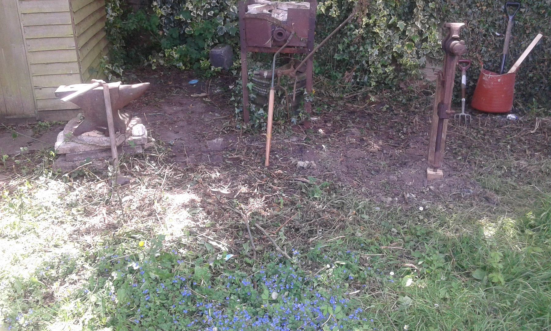

Looks like something of a scythette. Out of curiosity, what region of the world are you from?
I assume that question is for me given that my 'scythe' is rather a pathetic example. I'm from England. I can't tell you too much about the origins of the scythe because it is my dad's and I'm not really sure why he owns it. It's far too modern to have come from my great-grandparents' farm.
