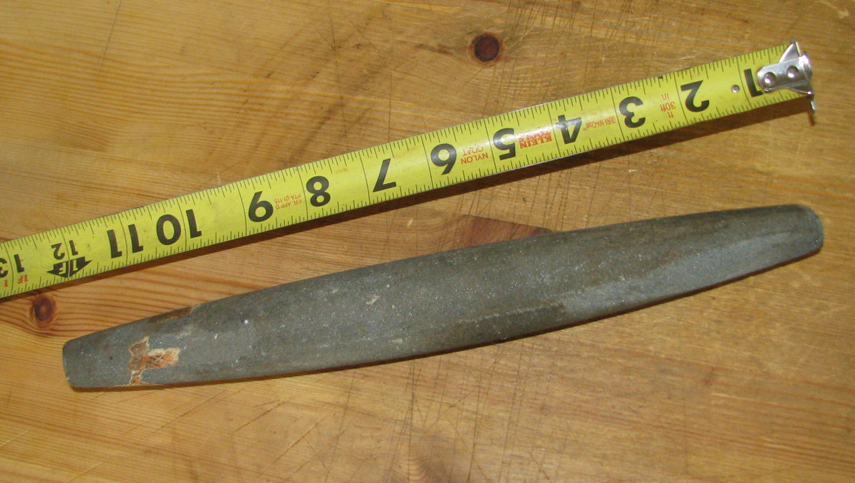

Not sure if this is a scythe stone or what. It's round, 12" long.
My guess is a Carborundum Niagara Scythe Stone, since the label could be the same color as the one pictured in this ad (supposedly from around 1905):
The round shape that you have seems to have been a popular type with the British.
It's an English style stone, as previously mentioned. If domestically produced it's probably by the aforementioned Niagara Carborundum Co. but it could be of foreign manufacture. I've yet to see a Niagara-produced stone of that type, but it doesn't mean they couldn't exist, by any stretch. I have seen a lot of the company's labels and they tend to be a gold-bordered red decal.
Thanks, guys.
I put the label under a magnifying glass and it says 'Indian'. There's and Indian Chief's head in a circle with words around it. Above lettering may include '....CAPPOR....', below lettering includes '....CHEST....' or maybe '...CHESTER...'.
Definitely carborundum not native stone.
Interesting that the Pike Mfg. Company (based in New Hampshire) had 55 types of scythe stones listed in this publication from 1891, including the "Imported English Round", and the "Ohio Round, English pattern" in both 9-1/2 and 12 inches:
