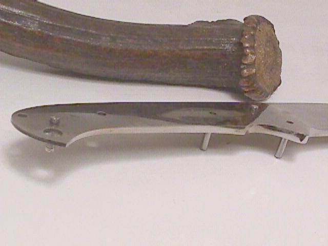

It should be done for you Dave. I have on order and expect to arrive first half of next week PBC coating from Brownell's, which if works as I hope will eliminate scaling and decarburation. I will test it out first on a sample or two of O1. If I decide it is not worth using the blade will be returned to you for grinding out the decarb.. Also within the same shippment is 2 gal. of Tough-Quench that I will also test out on some O1 before using on this blade. The two above items where recommended to me by our very own Bruce Bump so I expect happy results.
I am going to post pictures of Daves exquisite grinding before I heat treat.
RL

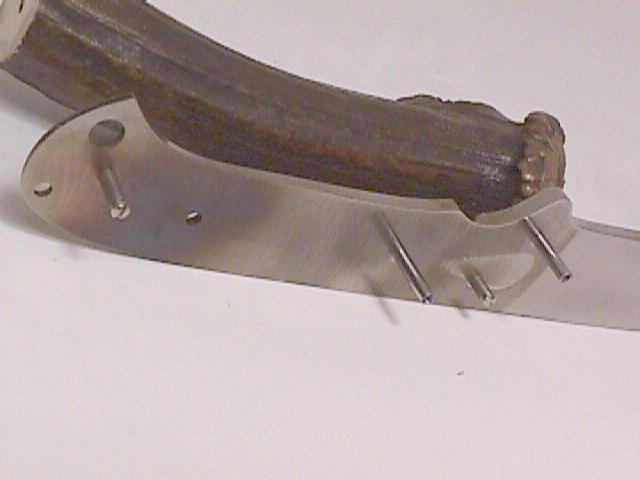

the template with holes done by yours truly and the Tang taper by Dave.
this template will be used to fit the handle material and it is relieved
for the profiling of the jade and handle material.
Sweet tapered tang!

Here all is a pix of Daves work. I can testify that both sides are alike and the plunge is a lesson in grinding.
Looks good! Roger I clean and recoat after each quench. The pbc just washes off with hot water. When the blade is preheating about 500f take it out and sprinkle the pbc on until nicely coated then pop it back in the oven until the curry point and quench. Do this 3 times and temper 3 times. "try it youll like it"
Man that looks nice, Dave.
